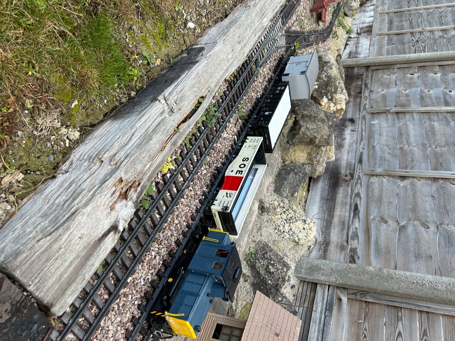

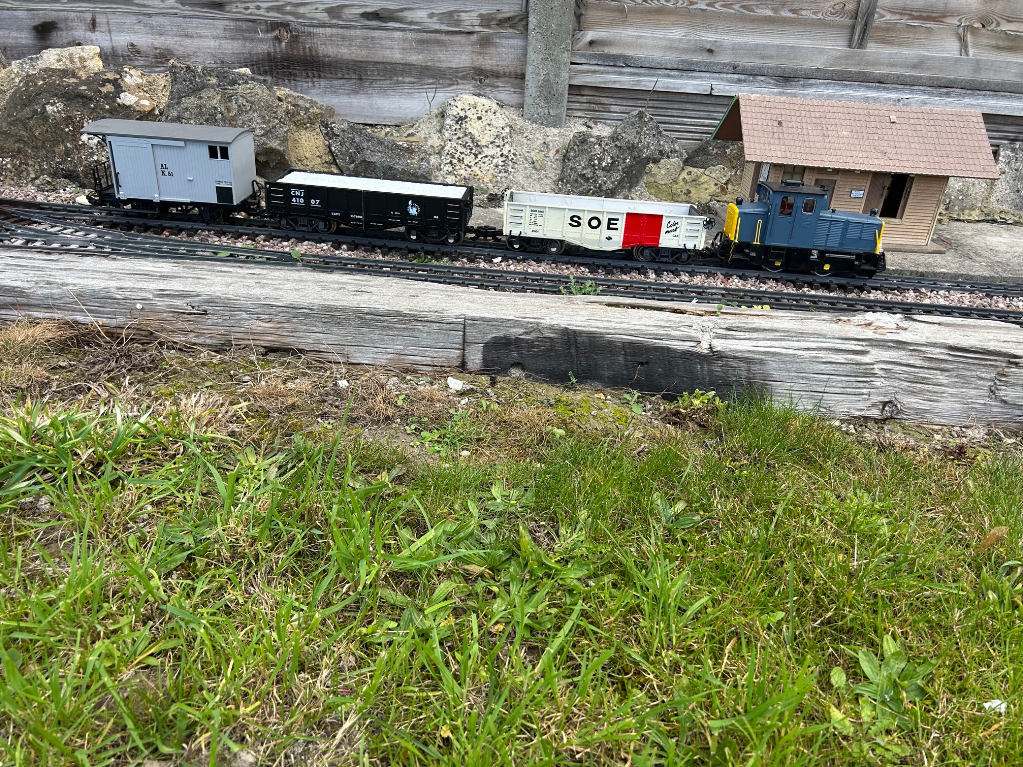

I’ve had an idea for a unique wagon for my layout, and that’s to shorten an aristocraft gondola to make something more suited to a narrow gauge line.
Has anyone done this before or got any links to any articles? I found one many years ago but it has since disappeared from the web
My plan is to cut at the two red arrows, taking care to ensure the panel seams are preserved
As seen the gondola looks a bit big behind a forney

I cut down a NQD coach as such....

Also you can have different lengths, I went for the shortest possible, but the 1st photo shows a longer option
