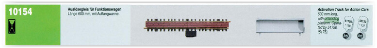

Do you know what track section is needed as Google didn't really help
I just had a look at the one I have, but I can't find an LGB number on it.
I'll try and see if I can find more details....
Found it, the Disengaging Rail is LGB 10154.
I haven't yet installed mine. It seems the wagon should have an electric motor inside which raises the side wall of the wagon. None of my 3 wagons has this motor installed as far as I can see.
The wheel sets should have carbon bullets on backs, but again mine don't have any or the wiring I would expect to see for any motor.
I brought my last 41613 wagon just before Christmas. It was quite cheap, and had plastic wheel sets. So I reckon it was a similar wagon in a differently numbered box. It did come with the LGB Service Instructions which show the circuit diagram for the motor.

Note the 'special' track for the LGB dumping gondola is an isolated track section and uses only one rail to power the same side of the car.
