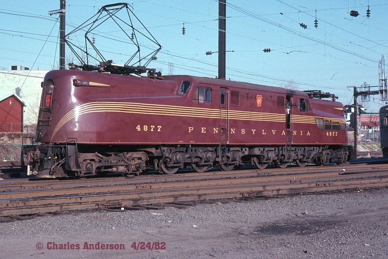

For the coach red a dark red oxide is fairly close - Jack Thompson has a freelance railroad and say his color is 'Pennsy Maroon' (Tuscan Red) so the DRG red would be a bit lighter.

A PRR GG1 in new condition (tuscan) is at
http://www.trainweb.org/railpix/miscpix/PRR_GG1ac4877-4-24-82.jpg < Link To http://www.trainweb.org/r..._GG1ac4877-4-24-82.jpg

Helpful, up to a point; don't know if it's my monitor but the shade of Thompson's stock "on screen" looks more like a purplish-brown than the red I've seen elsewhere. (I've got Olympus and Canon blaming each other for my sudden inability to print my pix in the shades as they appear on screen, despite using the correct paper, ink & printer settings...) I've also used Halford's primer on some freight vehicles, so to prevent a certain sameness, I might stick to a different green from the Bachmann plastic. Pity Testors are stopping production, according to what I read. Their name has been synonymous with US model paint for a long time. Loved the passengers. tho'.
