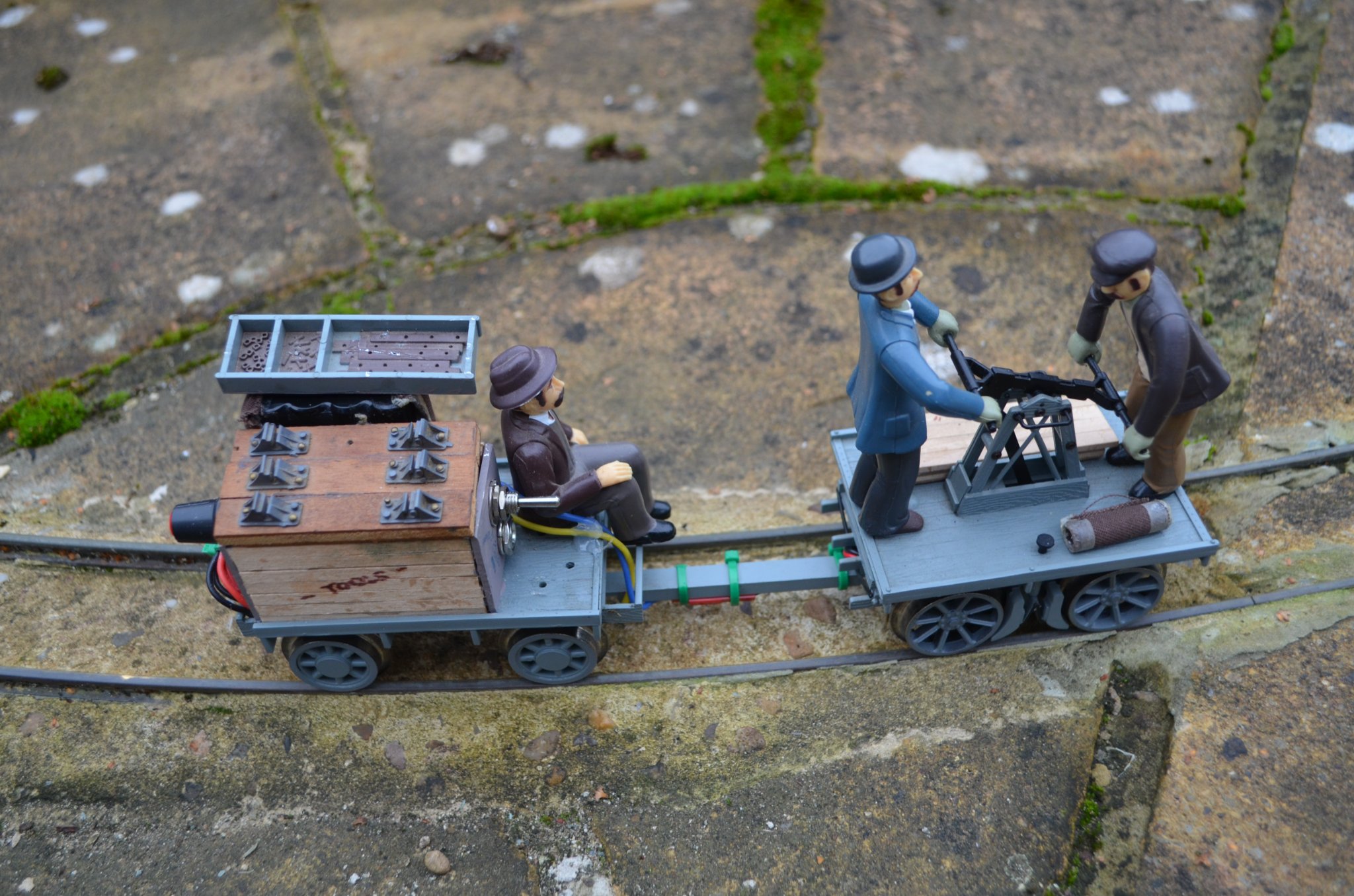

I had a Bachmann Christmas Gandy Dancer that ran (with a great deal of noise) last year. This year it stopped and on breaking it down to clean and test, the motor is completely gone. It just smokes if powered. All the threads I've searched here and elsewhere concern the 'rubber band drive' type. Mine is a double-worm-gear type. There must be somewhere I can get a motor of this size or type, OR even just roughly the same size that doesnt get in the way of the motion gears, and I can rebuild the holder with plasticard.
The Bachmann parts site and all other parts sites are of course, useless, as there's no information on size at all. The interior of the Gandy Dancer is pretty tight so I need something close if not identical. Anyone seen any other motors anywhere that are this sort of size and double ended?
I'm debating making the entire thing battery powered, but first I need to get a motor I can fit in there.

That looks very much like the sort of motor you'd get in an 00/H0 loco - 5 pole skew-wound.
You can get miniature gear pullers (on Amazon and other sites) albeit of dubious quality, but I have successfully pulled a few worm gears off. Measure the diameter of the shaft, and see if you can locate a 12v motor of suitable dimensions - you may have to be a bit persistent with the internet searching
HO loco motor is the right length and width but is 18mm thick against your 12mm.

It absolutely is the one they use in HO locos, which google image searches confirmed, but Bachmanns parts website is terrible. I'd need to trawl through 700+ search results. They wont even advise either.
I think I'm going to have to email all the UK repairs and parts dealers. Good call on the gear puller, I'll have to get one.

In the third pic it looks like the carbon brush that the black wire goes to is gone? Can you open the holder and remove the brushes or is it a sealed unit?
Well spotted - I'm not sure how easy it would be to get the motor back together :oops: It appears to rely on bending the metal parts over - usually something that works once only :mm:
Years ago, a friend of my father's spent a whole evening fashioning a carbon brush for one of my N gauge locos out of a piece of pencil lead, with ultimate, resounding success.
First pic too, now I know what to look for!
Yes, that is undoubtedly a 'standard' bachmann motor, probably used in an HO/OO diesel. I've done a similar swap with a Kader motor in the Bachmann tram.
In my experience, those brass brush holders are just a push fit in the nylon end frame/bracket. Try getting a slim screwdriver under the head or the brass that the wire is soldered to, and try a little leverage. You can also try a big screwdriver between the commutator and the brush holder inside the motor, but you can do more damage that way if you aren't careful.
You can fettle a brush from any carbon wheel pickup - the ones used on Aristo or USAT coaches tend to be bigger, but they are soft.
Incidentally, if you want to test all this, apply power to the 2 motor leads, and stick a screwdriver in the gap between the brush holder and the commutator, not touching anything else. It will act as a crude brush and the motor should try to spin. Don't do it for long!
I am going thru the same drill with a friends Bachmann Hand Car. I found a 5 pack of this motor on AliExpress (which I just found out they only sell them in a 10 pack now, about $2 US each with shipping). The shaft matches Bachmann 1.5mm diameter and hopefully is long enough for a stable mount and with enough power. I used a 25 year old slot car gear puller to remove the gear. More later.
