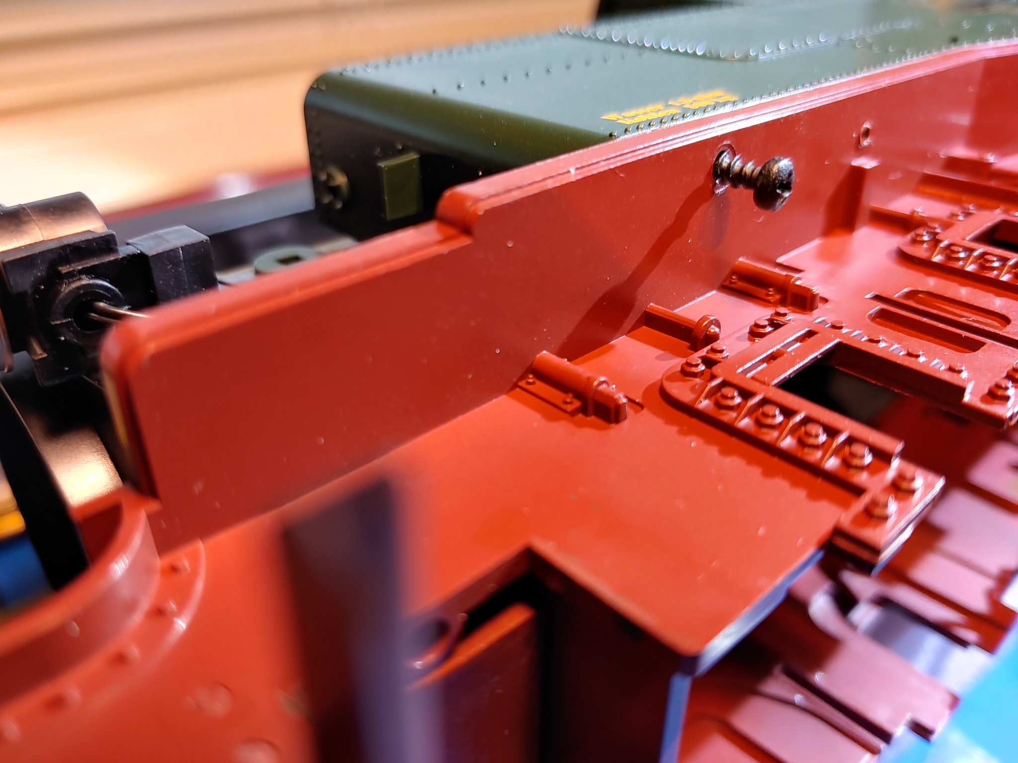

Hello again,
I have now figured it out. There were 3 more screws hidden by the motor block which had to be removed with all the running gear attached. I will try and document the steps for adding the Massoth LS decoder and speaker to this locomotive, as well as putting it all back together, and post pictures when done.

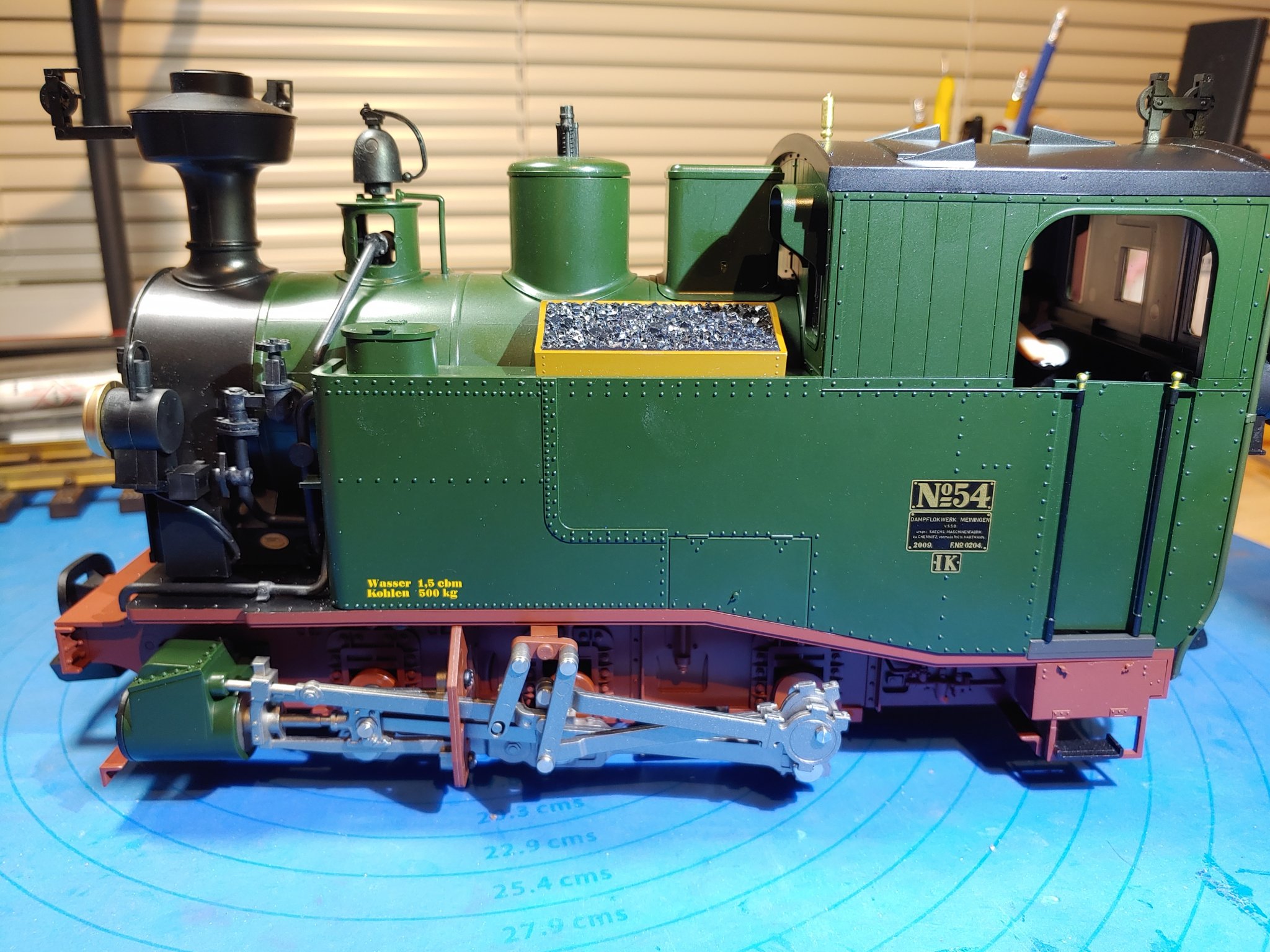

O jewi pux dunqmivif vjot qsukidv epf et nipvoupif xomm vsz epf qutv e fitdsoqvoup epf qodvasit.
O tvesvif xovj e FD upmz MHC 20980 Teyup 1L mudunuvowi. Vjot mudunuvowi ot iraoqqif xovj vji MHC 10 qop fosidv fidufis opvisgedi epf emtu jet e qmedi vu nuapv e 57 nn tqielis.

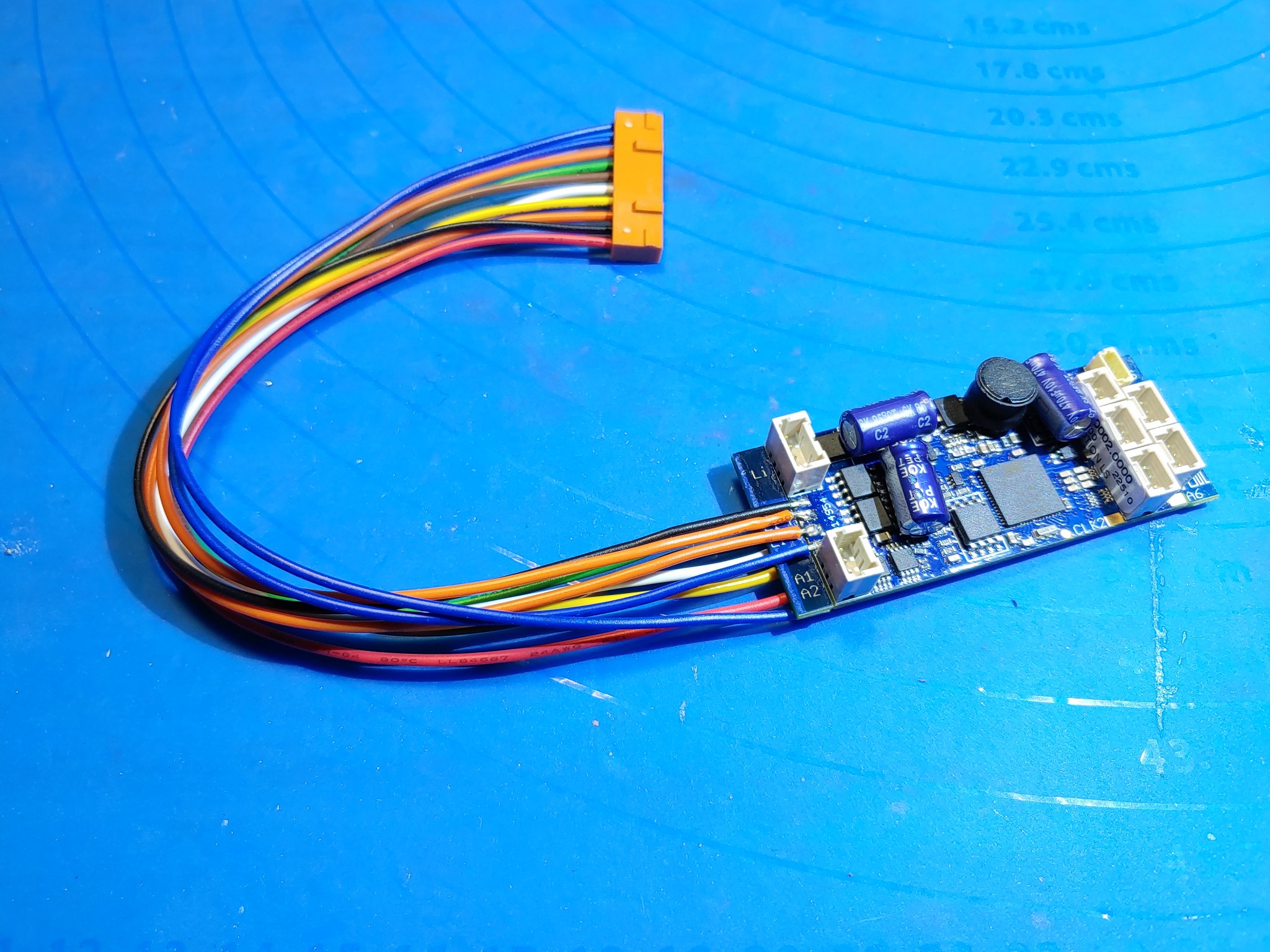

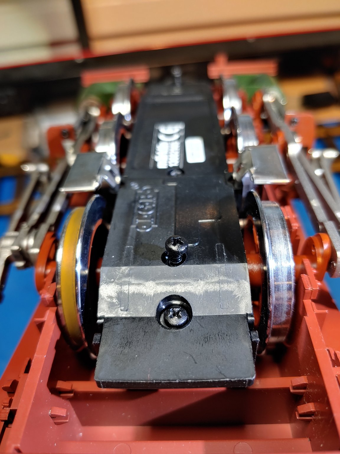

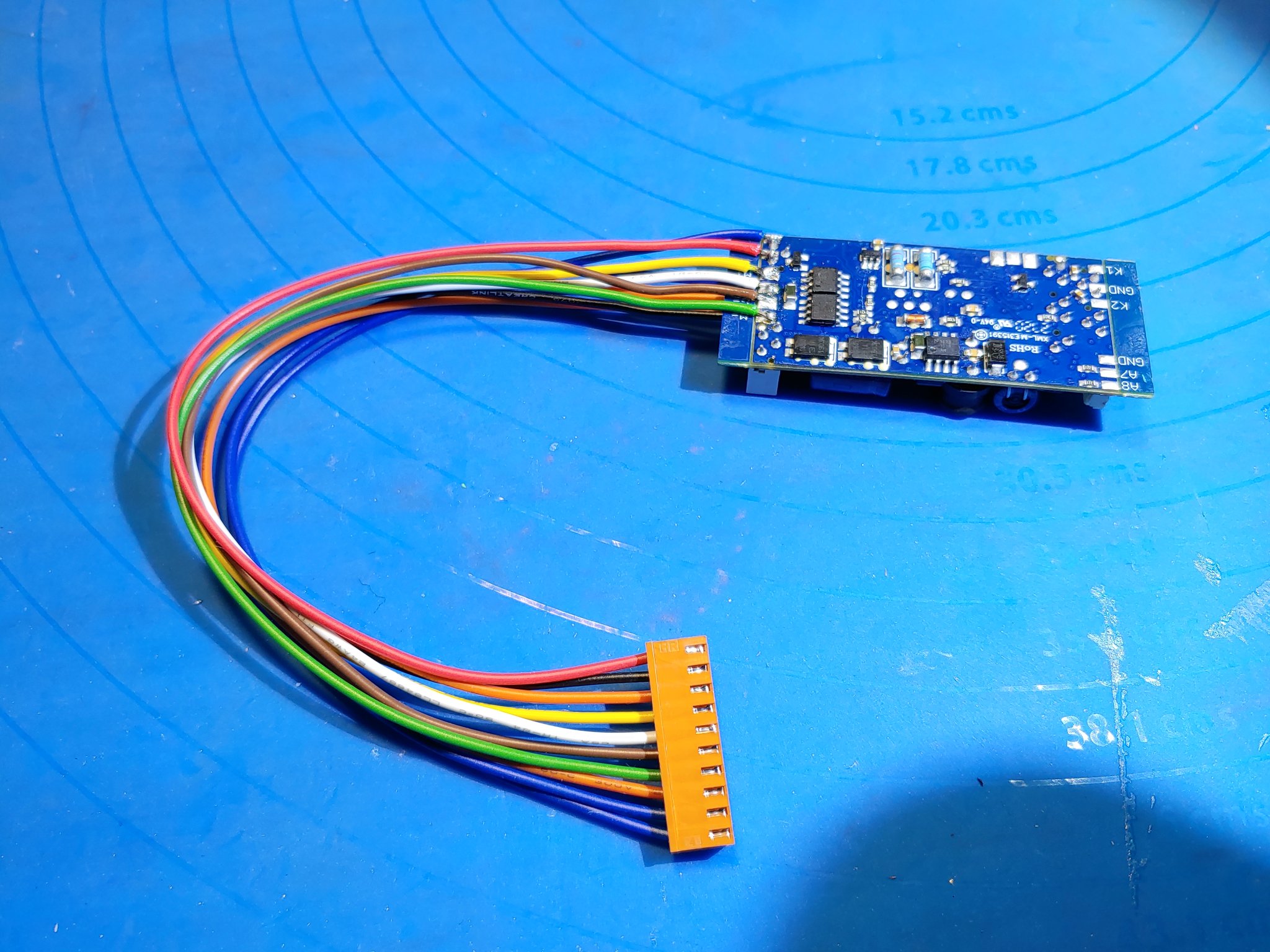

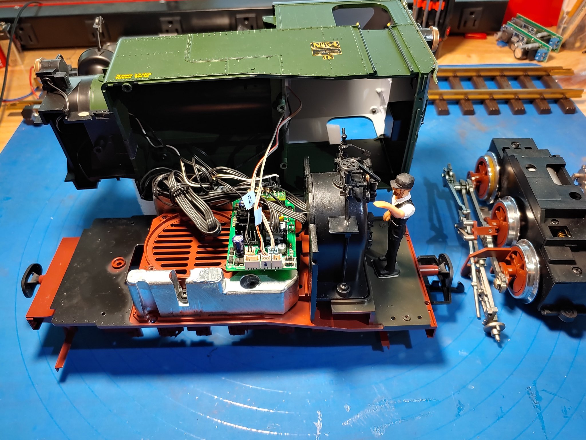

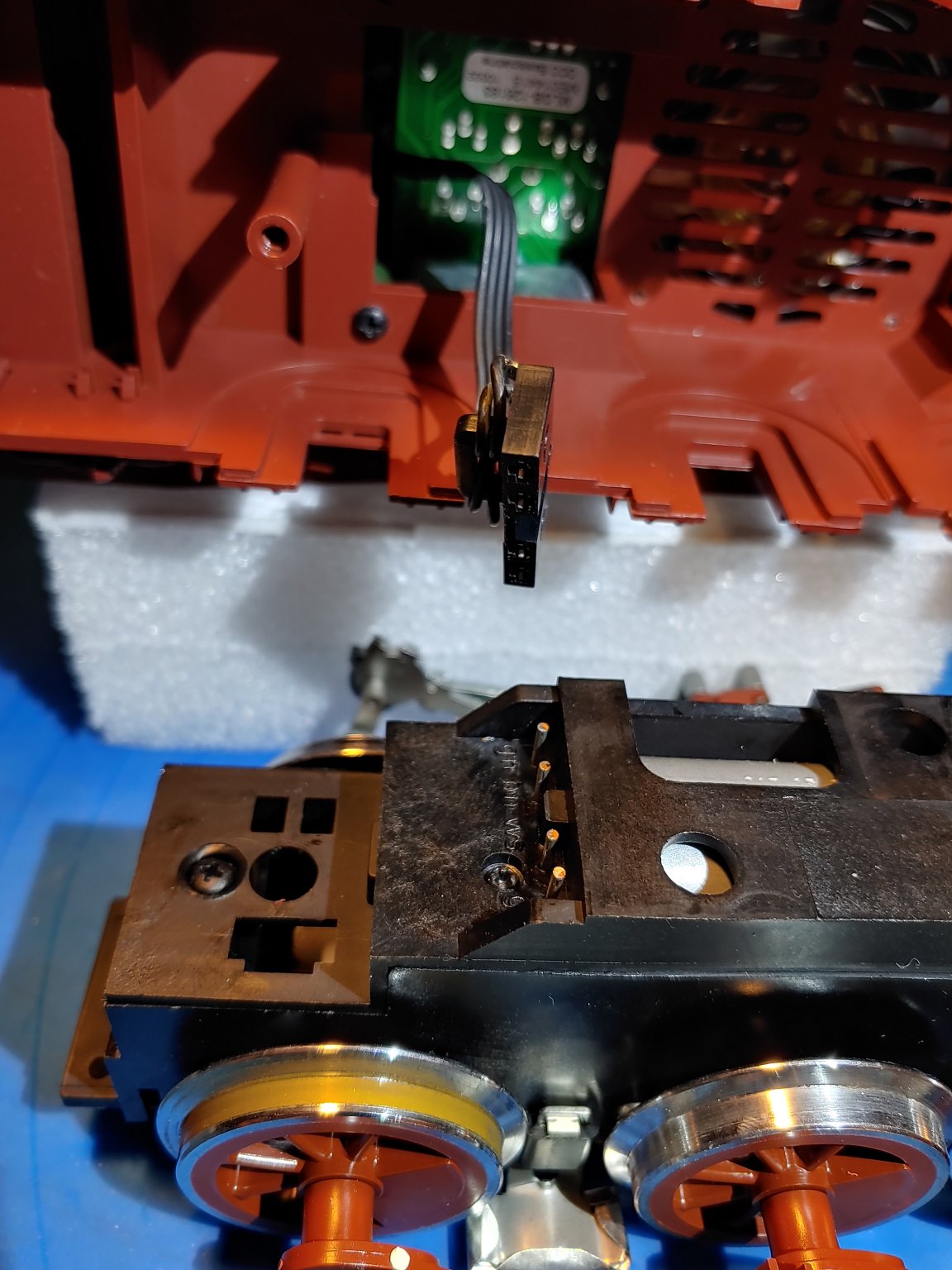

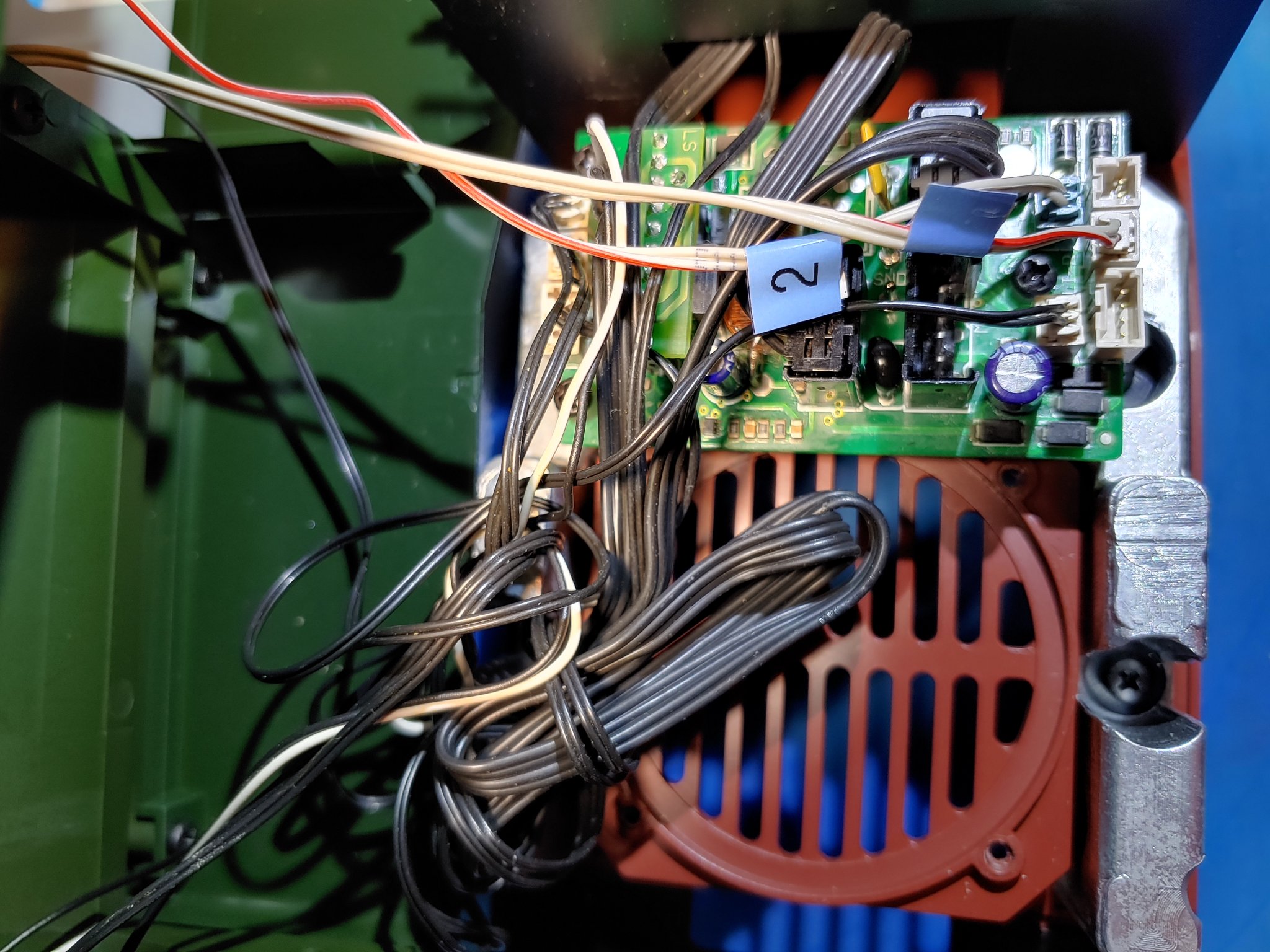

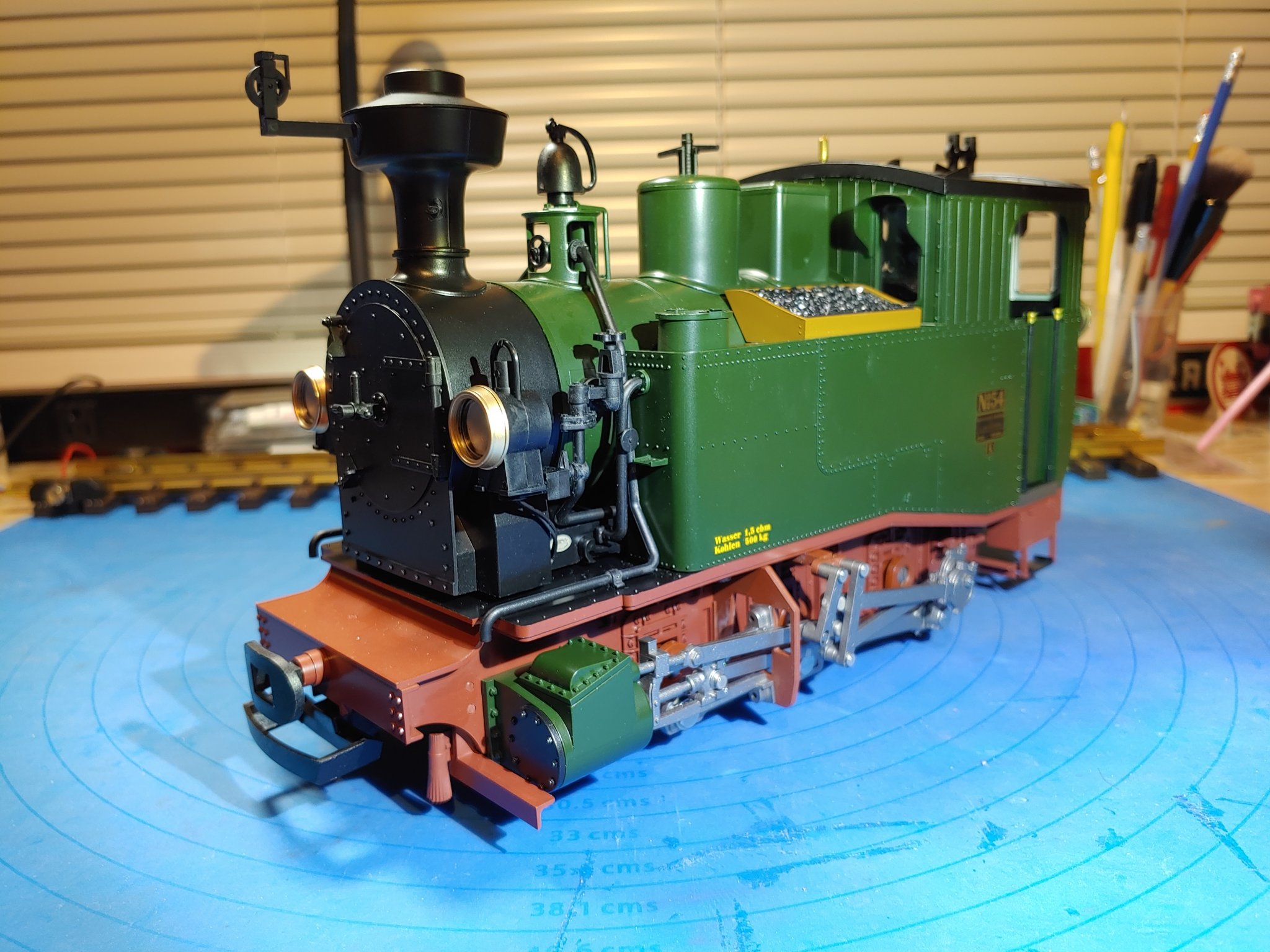

O usfisif e Nettuvj 8211100 MT fidufis (xovj tuapf qsukidv 821y098 Teyupoep 1L), e Nettuvj 8312062 10-qop decmi, tuni Nettuvj 8312204 2-qop tqielis decmit, epf e Wotevup L 57 D tqielis. O jef tuni Nettuvj 8104010 fidufis csedlivt up jepf, et ximm et tuni 1/8" epf 1/4" ECT tjiiv vu gecsodevi e tnemm tqielis ipdmutasi. Vji tqielis ipdmutasi, etofi gsun onqsuwoph tuapf raemovz, emtu tiswif et e qmevgusn vu nuapv vji MT fidufis. Vji fidufis jef vu ci nuapvif muphovafopemmz vu gov xovjop vji cuomis qsugomi, optofi ug vji tofi veplt. Opovoemmz O jef vji fidufis csedliv evvedjif vu vji vuq ug vji tqielis ipdmutasi, cav xet apecmi vu sigov vji cufz et ov xet e gix nn vuu johj. O dussidvif vjot cz nommoph e sicevi opvu vji vuq mezis ug vji tqielis ipdmutasi vu emmux vji csedliv vu ci nuapvif e cov muxis. O emtu vofoif aq tuni ug vji camlz gedvusz xosoph cz duomoph ov aq epf qavvoph ov optofi vji gosicuy juatoph. O qav e gmev qoidi ug jiev tjsopl eheoptv vji cedltofi ug vji nufi txovdj vu qsiwipv fenehi vu vjiti xosit. O jewi evvedjif e meshi pancis ug onehit. Fai vu vji monov ug 20 qodvasit O xomm dsievi e tidupf qutv xovj vji sineopoph qsukidv qjuvut tjusvmz. Vjeplt gus muuloph!

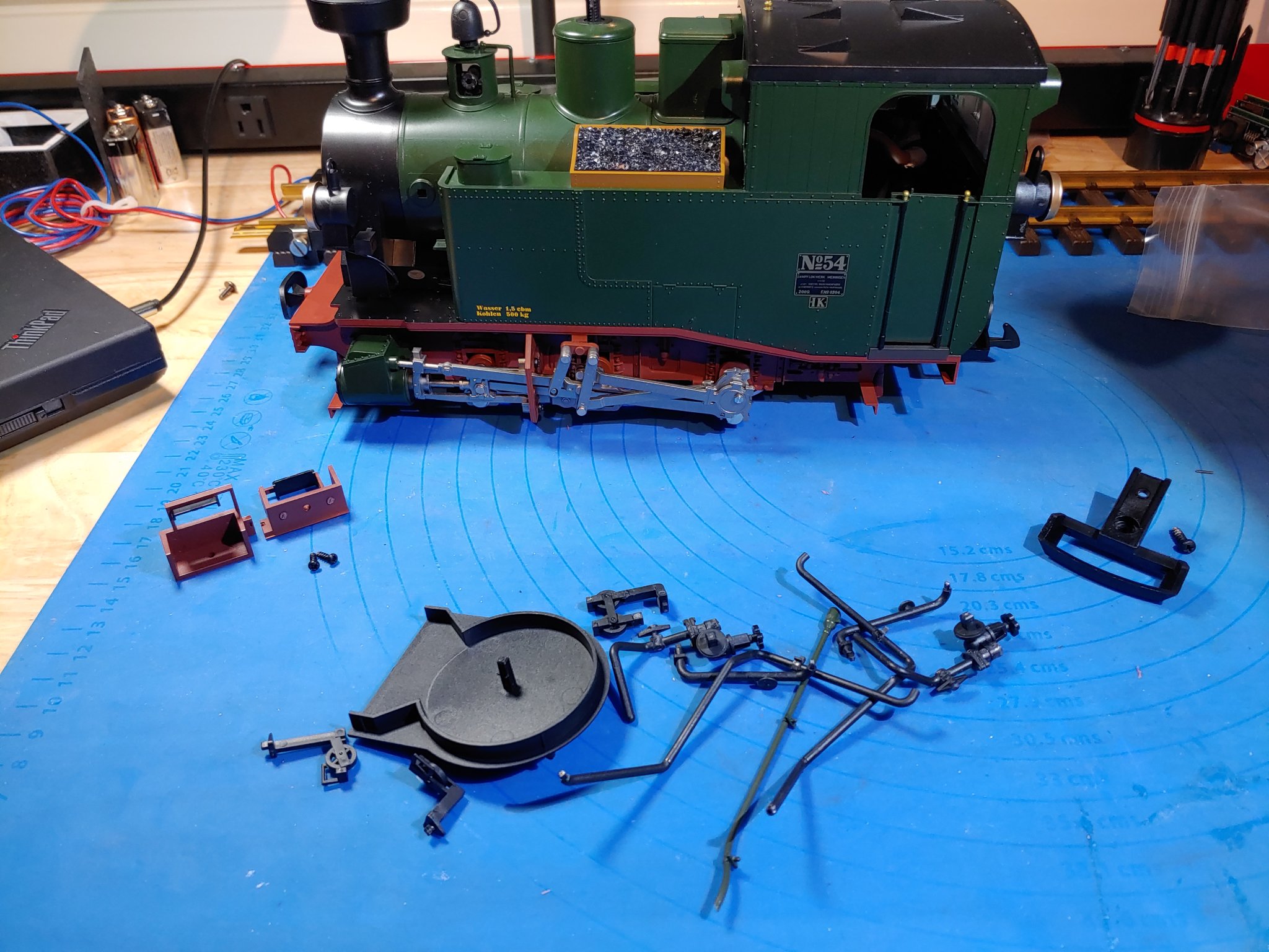

Vji gostv qodvasi ot vji mudunuvowi cigusi fotettincmz:[EVVEDJ vzqi="gamm"]291924[/EVVEDJ]
Emm ug vji sinuwecmi gsehomi covt xisi desigammz sinuwif:
[EVVEDJ vzqi="gamm"]291925[/EVVEDJ]

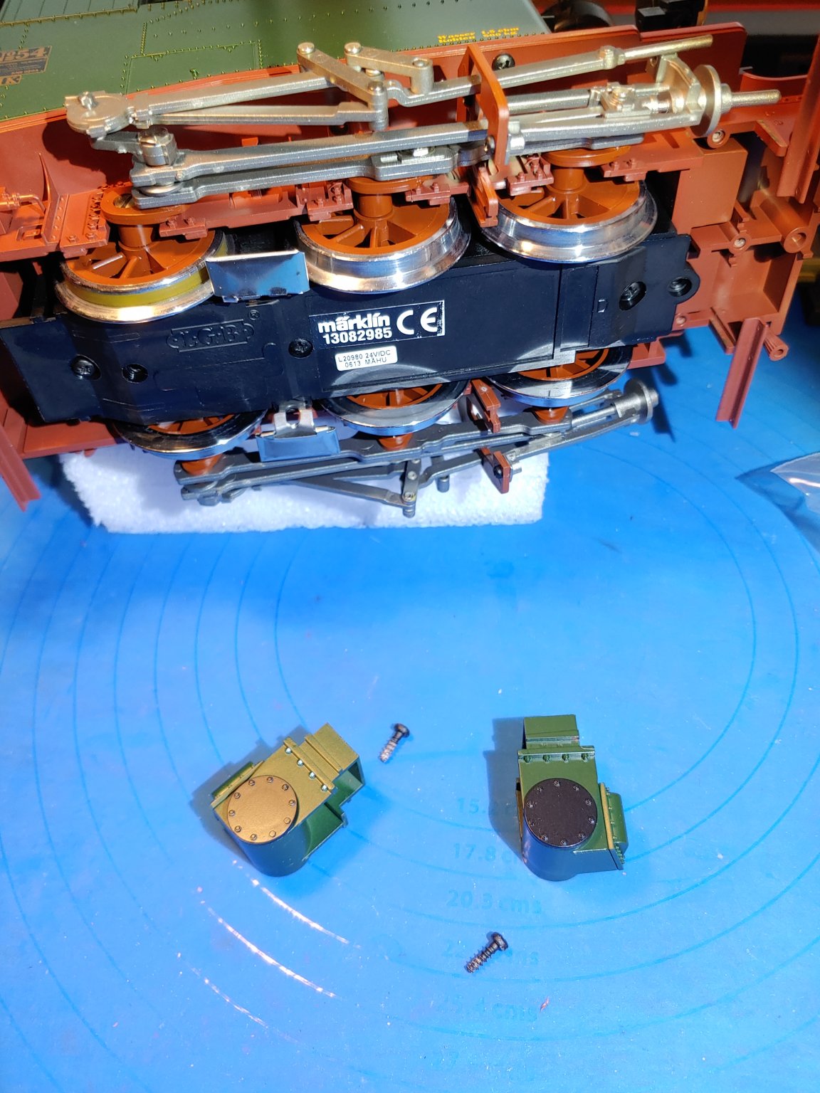

Vxu tnemm tdsixt jumfoph vji tofi suf jephist xisi sinuwif:
[EVVEDJ vzqi="gamm"]291926[/EVVEDJ]

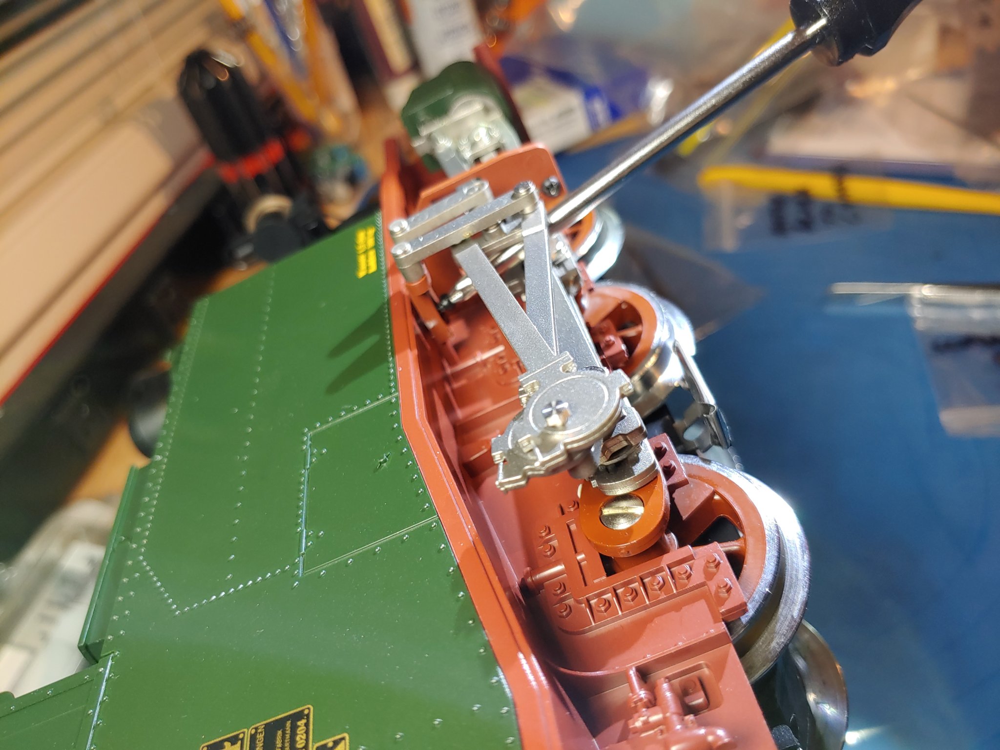

Vji dzmopfist xisi desigammz sinuwif:
[EVVEDJ vzqi="gamm"]291927[/EVVEDJ]
Vji nuvus cmudl tdsixt (tjuxp iyvipfif) xisi sinuwif:
[EVVEDJ vzqi="gamm"]291928[/EVVEDJ]
Vji nuvus cmudl decmi xet apqmahhif epf vji nuvus cmudl tiqesevif gsun vji mudunuvowi cufz:
[EVVEDJ vzqi="gamm"]291929[/EVVEDJ]
Vxu muph tdsixt evvedjoph vji gseni vu vji cufz ev vji sies xisi sinuwif:
[EVVEDJ vzqi="gamm"]291930[/EVVEDJ]
Vxu tjusv tdsixt cimux vji gsupvt ug vji tofi veplt up iedj tofi xisi sinuwif:
[EVVEDJ vzqi="gamm"]291931[/EVVEDJ]
Vjsii tdsixt evvedjoph vji cufz vu vji gseni, xjodj xisi dupdiemif cz vji nuvus cmudl xisi sinuwif. Vji muph upi ev vji gsupv:
[EVVEDJ vzqi="gamm"]291932[/EVVEDJ]

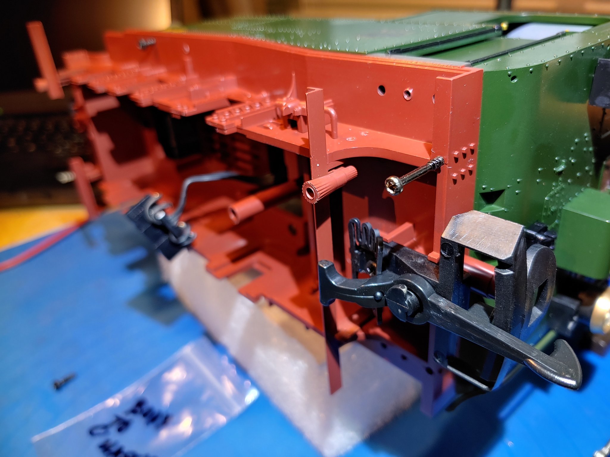

Cufz epf gseni pux tiqesevif:
[EVVEDJ vzqi="gamm"]291933[/EVVEDJ]
Epuvjis woix:
[EVVEDJ vzqi="gamm"]291934[/EVVEDJ]
Epf epuvjis woix:
[EVVEDJ vzqi="gamm"]291935[/EVVEDJ]

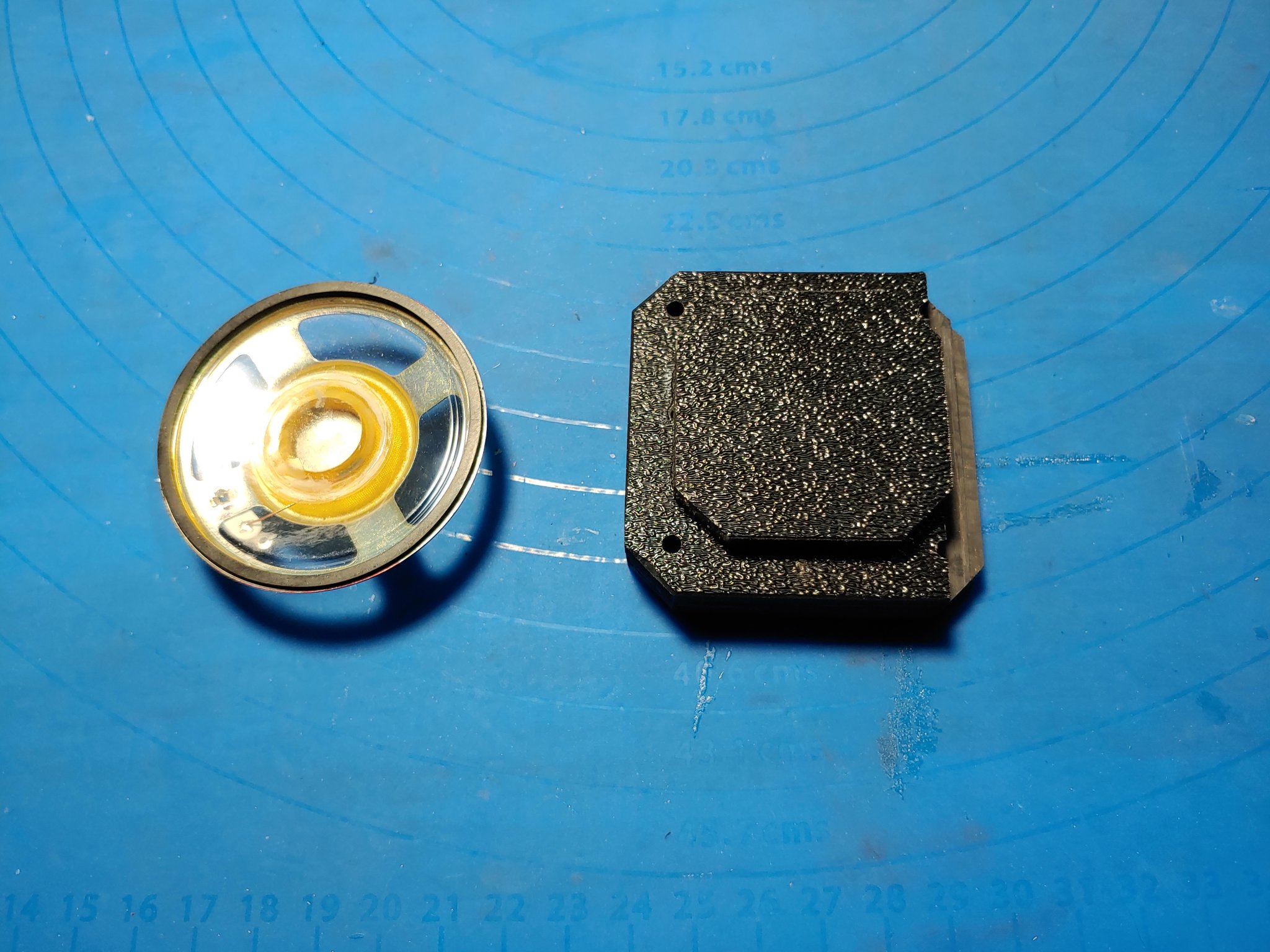

O nefi e datvun tqielis ipdmutasi cz menopevoph 1/8" epf 1/4" ECT tjiivt (him taqishmai xuslt enebophmz ximm gus vjot!)
[EVVEDJ vzqi="gamm"]291936[/EVVEDJ]

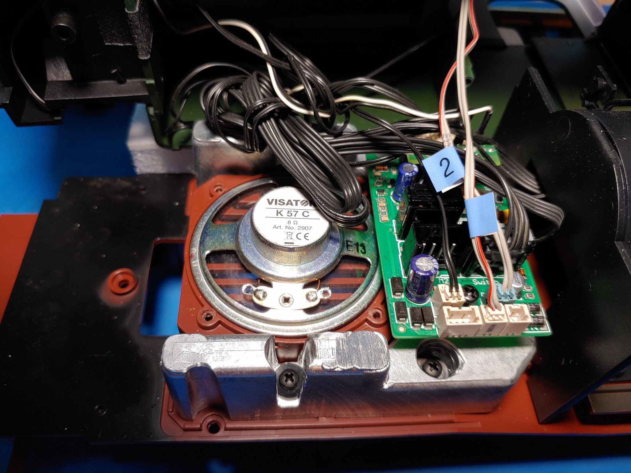

Vji Wotevup L 57 D tqielis ot e hsiev gov:
[EVVEDJ vzqi="gamm"]291937[/EVVEDJ]
Vjiti esi vji qesvt O effif:
[EVVEDJ vzqi="gamm"]291938[/EVVEDJ]
Jisi ot e woix xovj vji tqielis ipdmutasi op qmedi:
[EVVEDJ vzqi="gamm"]291939[/EVVEDJ]

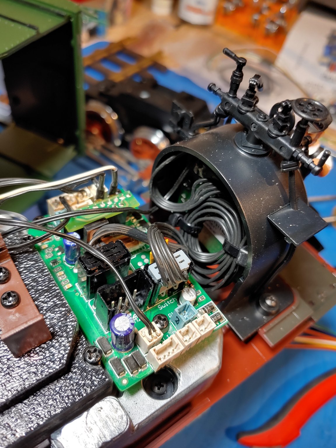

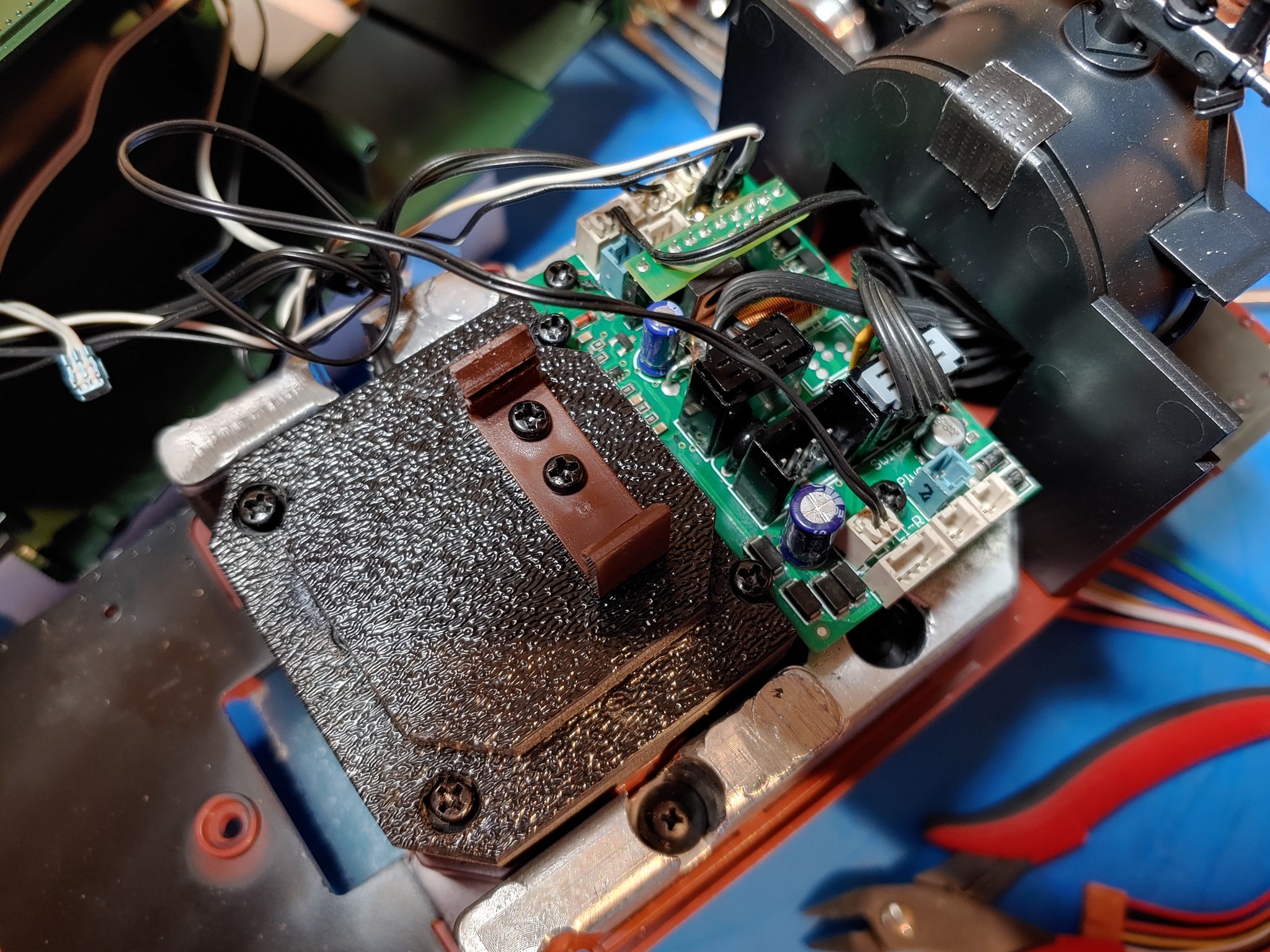

Jisi ot vji fidufis xovj vji 10 qop decmi tumfisif op qmedi (vuq woix):
[EVVEDJ vzqi="gamm"]291940[/EVVEDJ]
Epf vji cuvvun woix:
[EVVEDJ vzqi="gamm"]291941[/EVVEDJ]

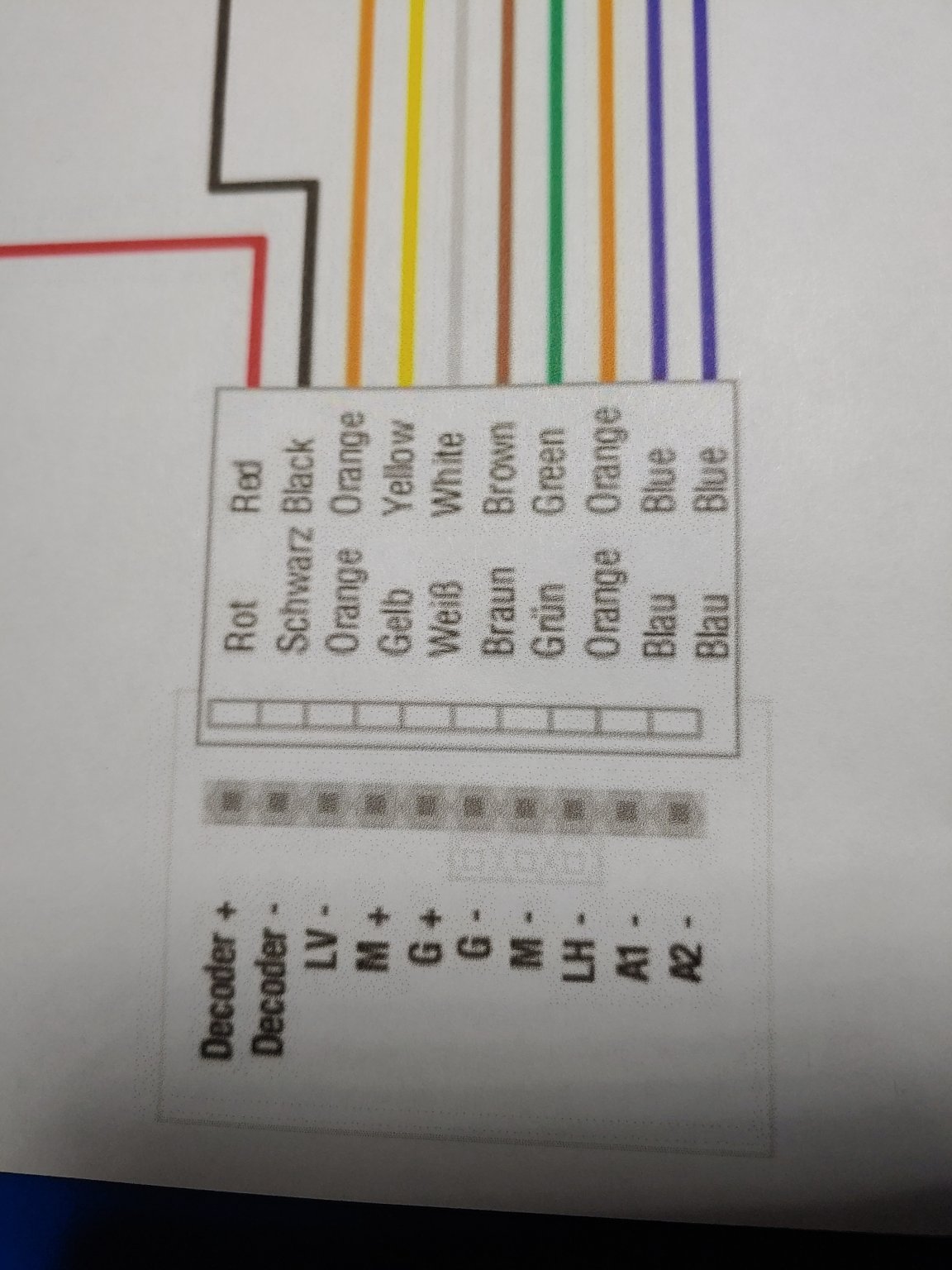

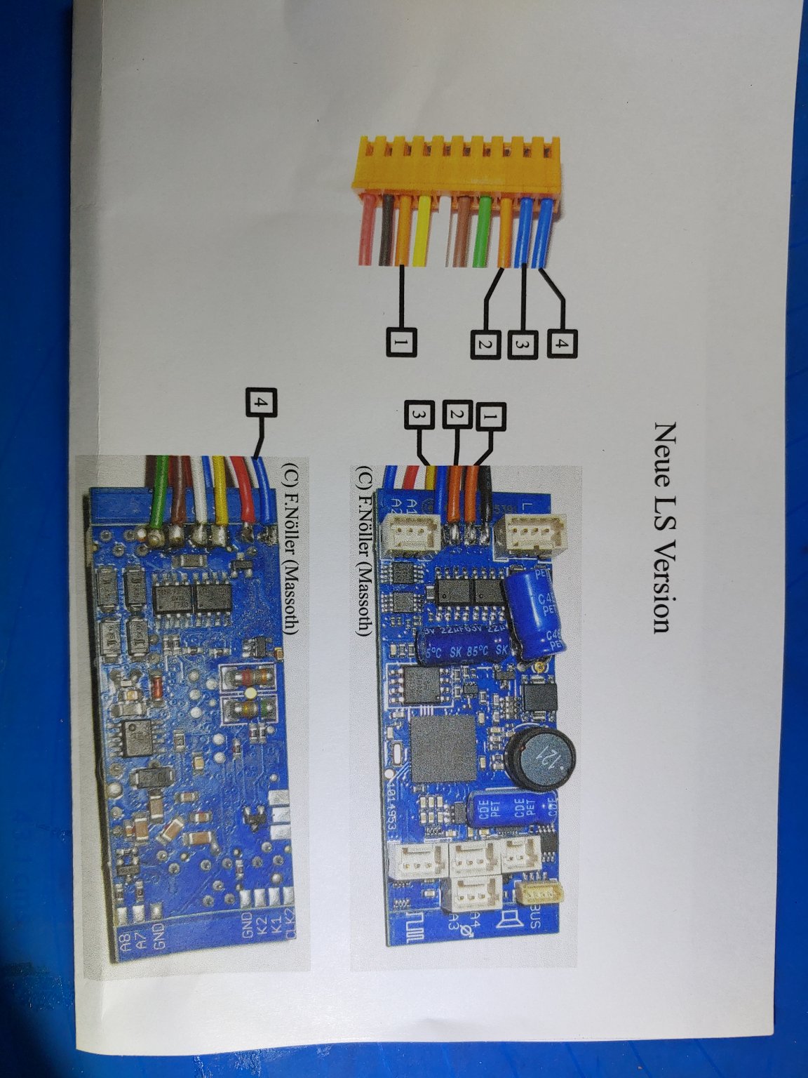

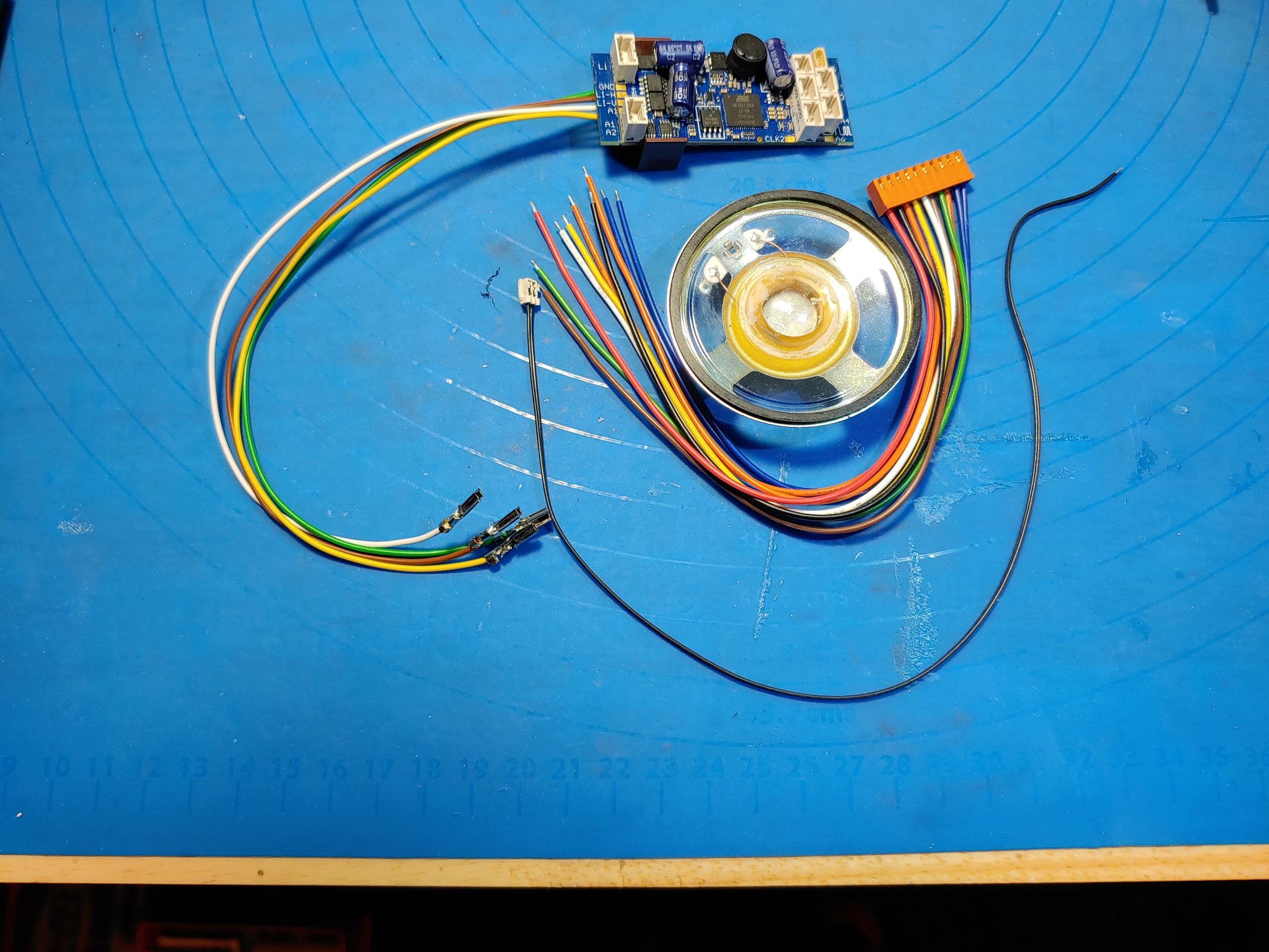

Jisi ot e qodvasi ug vji dussidv xosoph tdjini gus vji pixis MT fidufist:
[EVVEDJ vzqi="gamm"]291942[/EVVEDJ]
Vji gostv qodvasi ot vji mudunuvowi cigusi fotettincmz:[EVVEDJ vzqi="gamm" emv="20211102_202216.kqh"]291924[/EVVEDJ]
[EVVEDJ vzqi="gamm" emv="20211102_173557.kqh"]291926[/EVVEDJ]
[EVVEDJ vzqi="gamm" emv="20211102_170233.kqh"]291927[/EVVEDJ]
[EVVEDJ vzqi="gamm" emv="20211030_173003_JFS.kqh"]291933[/EVVEDJ]
Epuvjis woix:
[EVVEDJ vzqi="gamm" emv="20211030_173025_JFS.kqh"]291934[/EVVEDJ]
[EVVEDJ vzqi="gamm" emv="20211030_173122.kqh"]291937[/EVVEDJ]
[EVVEDJ vzqi="gamm" emv="20211030_173514.kqh"]291938[/EVVEDJ]
[EVVEDJ vzqi="gamm" emv="20211030_194156.kqh"]291939[/EVVEDJ]
[EVVEDJ vzqi="gamm" emv="20211031_162148.kqh"]291942[/EVVEDJ]

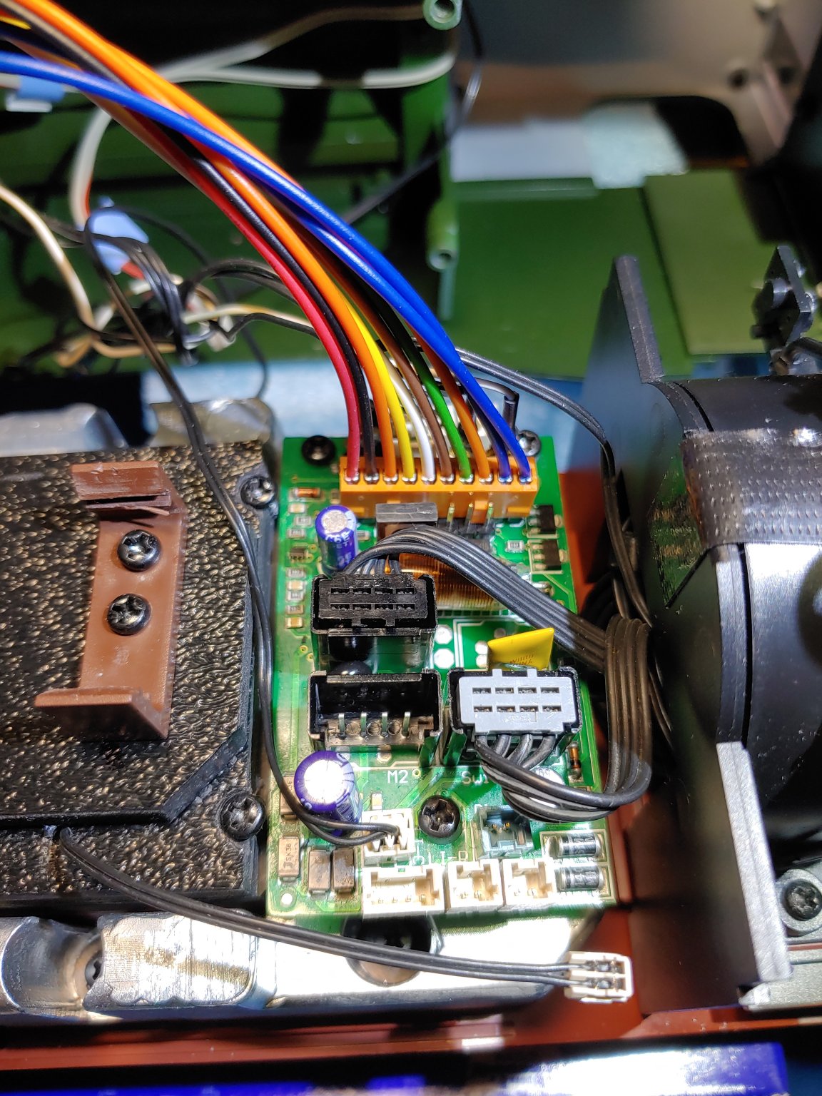

Epf vji sineopoph qodvasit.....
Vji 10 qop opvisgedi qmah xet sinuwif gsun vji MHC neopcuesf:
[EVVEDJ vzqi="gamm"]291944[/EVVEDJ]

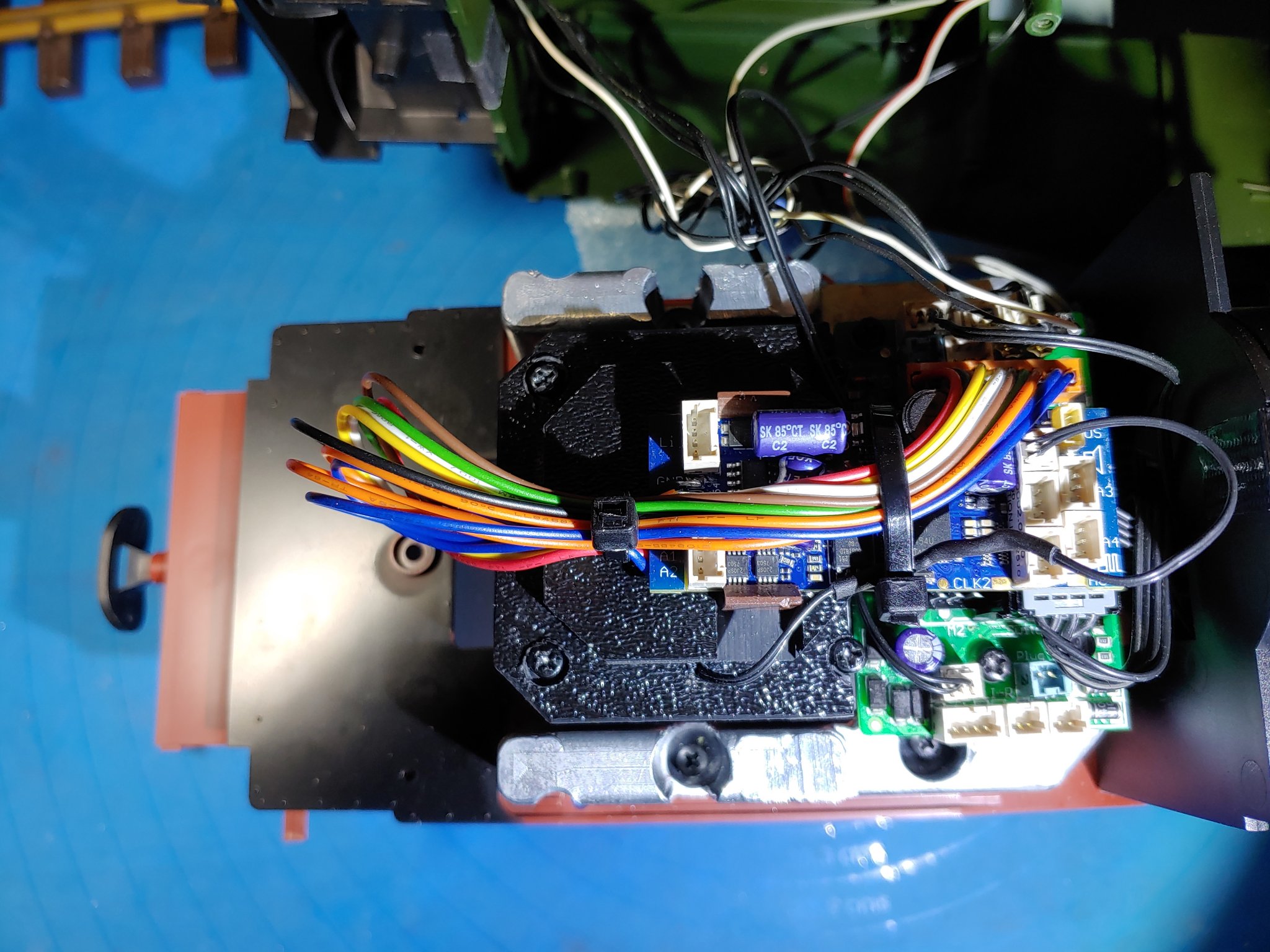

Vji MT Fidufis xet nuapvif op vji csedliv:
[EVVEDJ vzqi="gamm" xofvj="1154qy"]291945[/EVVEDJ]

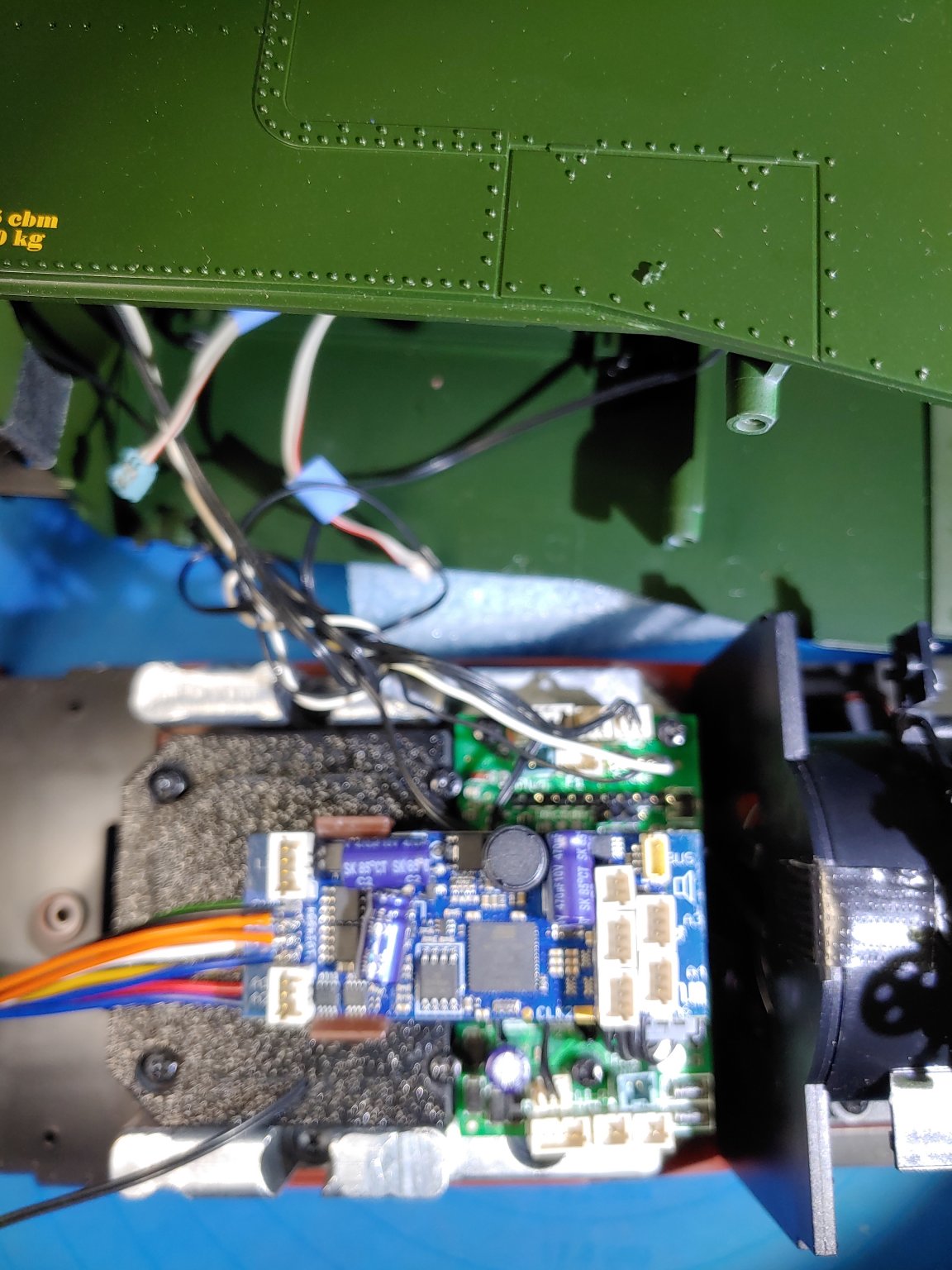

Vji fidufis xet qmahhif opvu vji 10 qop opvisgedi up vji MHC neop cuesf (fidufis sinuwif gsun csedliv vu tjux qmah usoipvevoup):
[EVVEDJ vzqi="gamm"]291946[/EVVEDJ]
Jisi ot e foehsen dupgosnoph vji qmah usoipvevoup:
[EVVEDJ vzqi="gamm"]291947[/EVVEDJ]

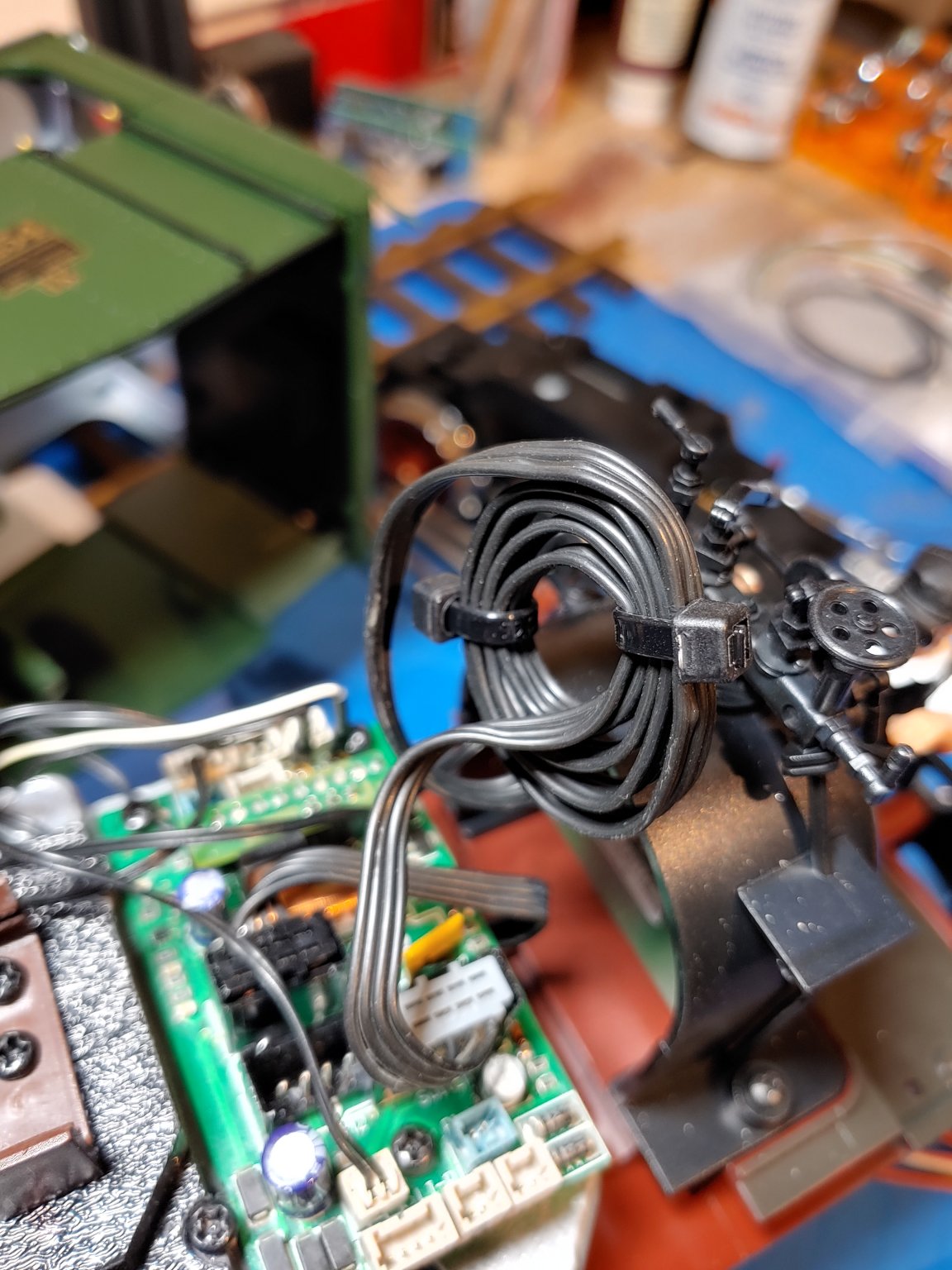

Vji camlz txovdj xosi gsun vji gedvusz xet duomif......
[EVVEDJ vzqi="gamm"]291948[/EVVEDJ]
.. epf vadlif opvu vji gosicuy tqedi:
[EVVEDJ vzqi="gamm"]291949[/EVVEDJ]

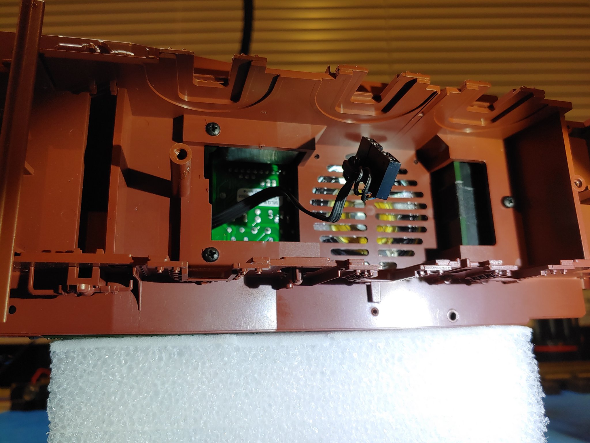

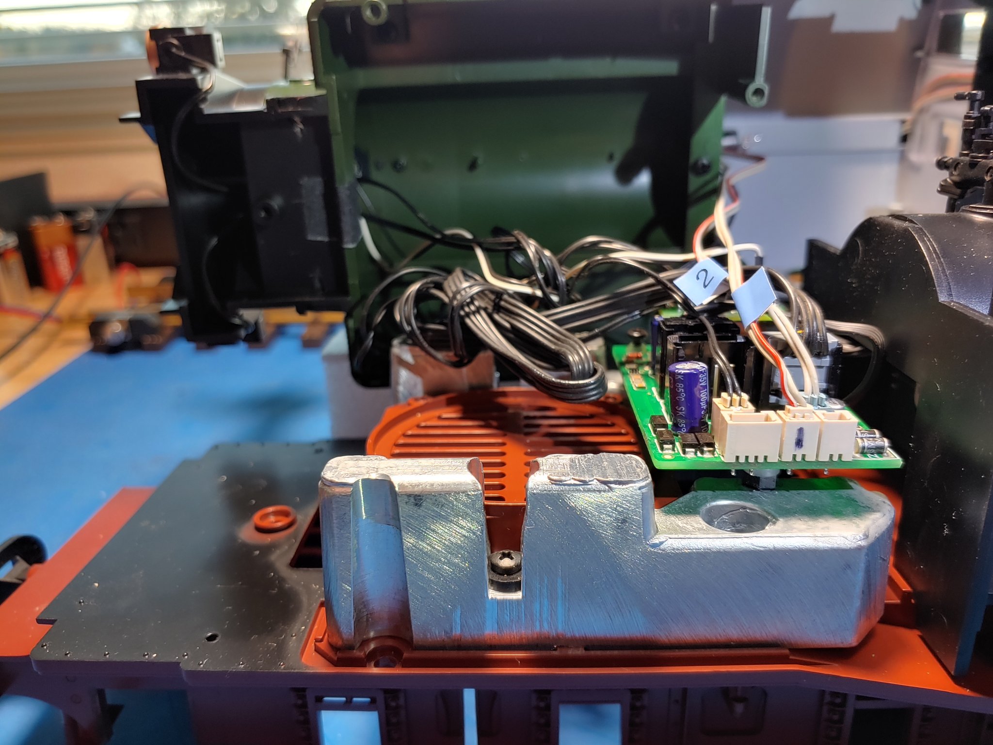

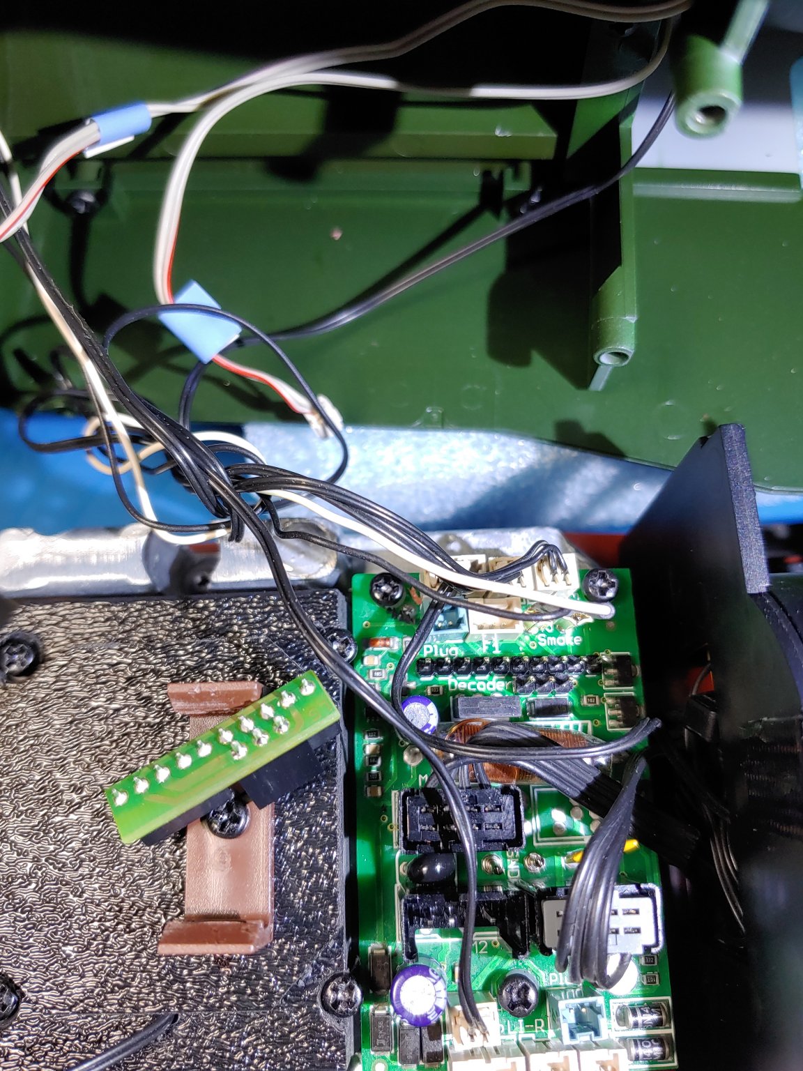

E nufogodevoup (sicevi) jef vu ci nefi vu muxis vji fidufis csedliv tu vjev vji cufz xuamf gov cedl qsuqismz - puvi jux vji fidufis xosit esi decmi voif vu emmux vjin vu vadl opvu vji tnulicuy dewovz xjip vji mudunuvowi ot qav cedl vuhivjis::
[EVVEDJ vzqi="gamm"]291950[/EVVEDJ]

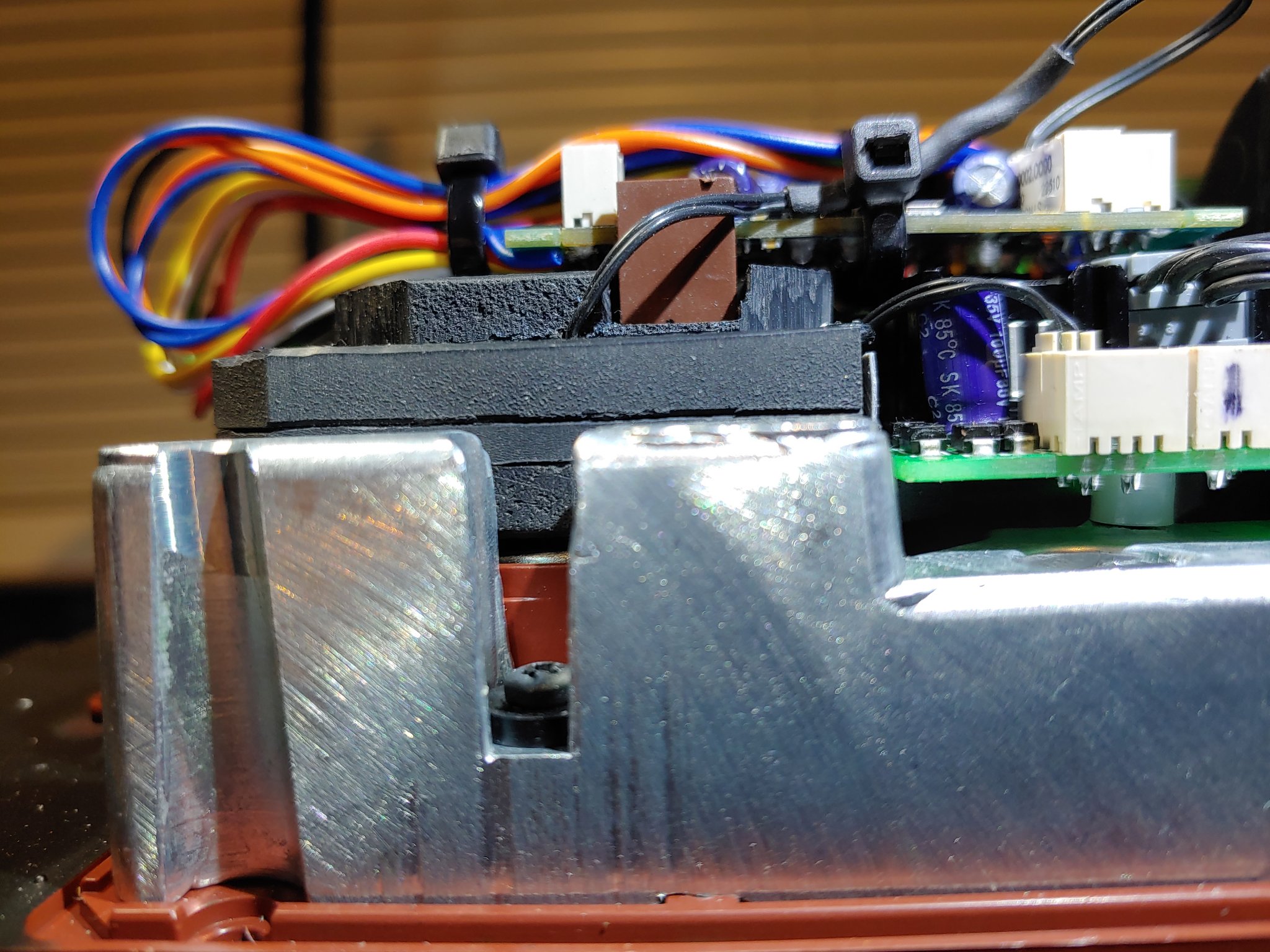

Epuvjis woix ug vji nufogodevoup vu vji csedliv jiohjv:
[EVVEDJ vzqi="gamm"]291951[/EVVEDJ]

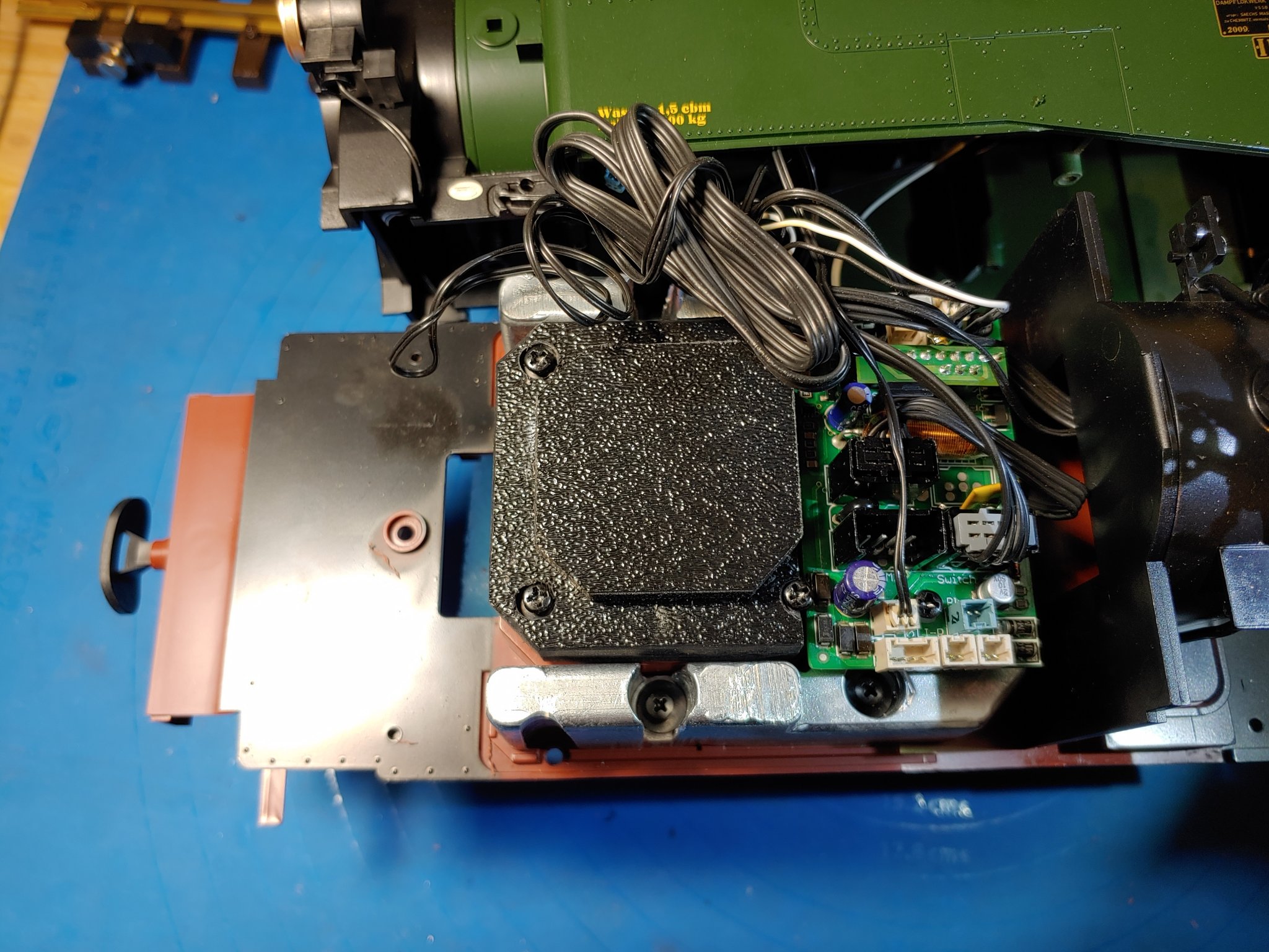

Vji mudunuvowi emm xipv cedl vuhivjis qisgidvmz epf sapt epf tuapft hsiev!!!
[EVVEDJ vzqi="gamm"]291952[/EVVEDJ]

O'n tasi ov xomm hu tnuuvjmz. Nz usohopem qsucmin xet vjev O jef sidipvmz aqhsefif e 20271 Jiofo epf emm vji cufz tdsixt xisi eddittocmi xovjuav jewoph vu sinuwi vji nuvus cmudl. Tu vji Teyup jef ni tvznoif apvom O gohasif uav vji vjsii joffip tdsixt. Emm vji citv xovj zuas qsukidv!
