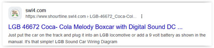

That would be why I found this conflicting advice (to "plug it into an LGB locomotive") in a web search (linking to a page deemed "too dangerous to view" by my browser!) . . .

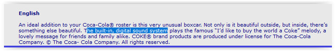

According to the GBDB website . . .
. . . but it does need a 9v battery attached to make it work.
