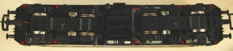

How do I remove the LGB E 10 body. I can see 4 screws, to each side but after slackening them it still seems too tight. have I mssed something ?
There are a total of 10 screws holding the body....
Many thanks, now I know the ones I missed. Will look again with my headlight.! gep4
