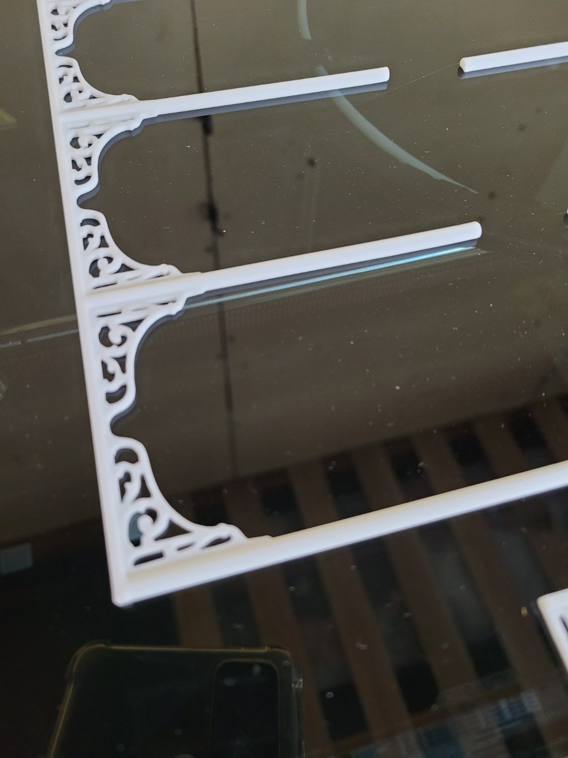

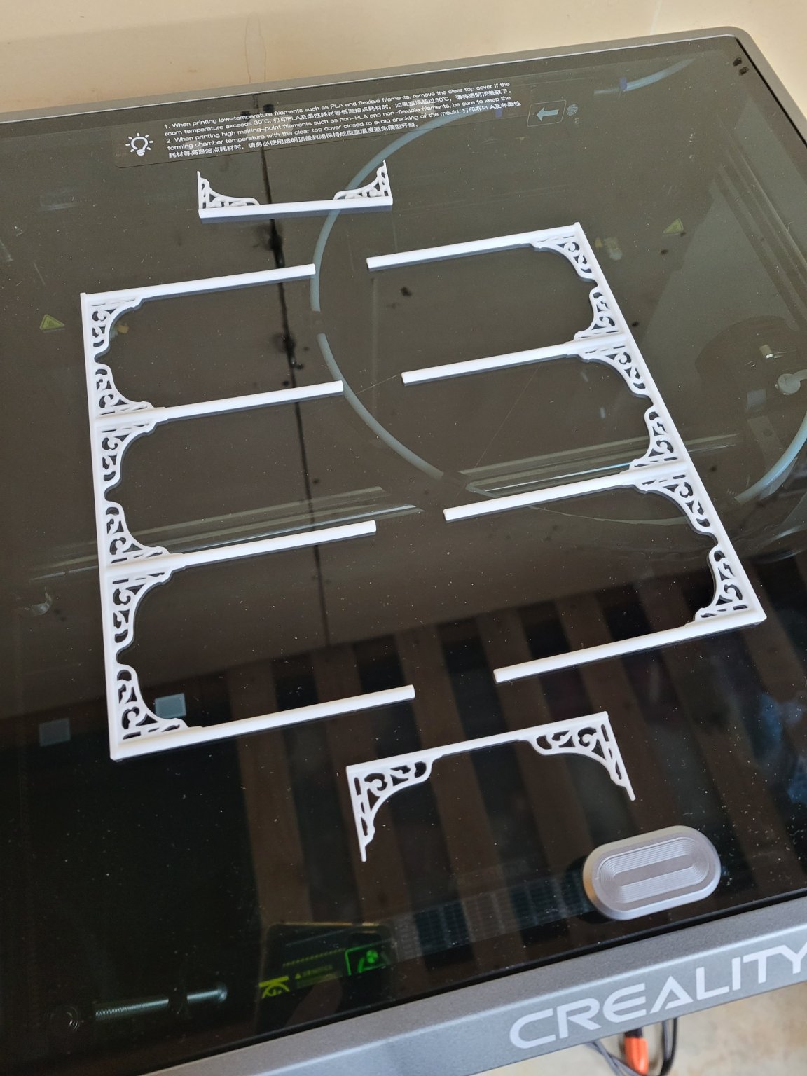

I test fit the micro switches to turn the smoke and fire box flicker on and off! Too cold to paint so I started cobbling together some passenger cars based loosely on the grizzly cloe cars. I used some elements from the closed Saxon 1k cars, some park benches and some fancy shelf brackets shrunk down!
