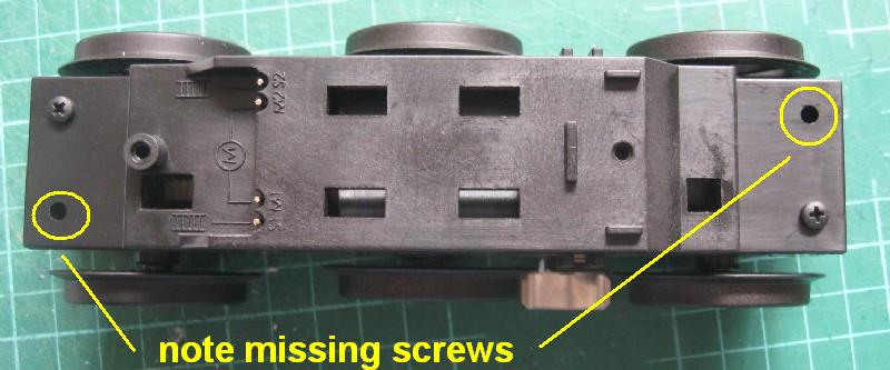

I suspect one of the cables [ see the picture of a PIKO Taurus http://swl4.com/image/PIKO-37420_E-...E-Loc_RTS_Tarus_wiring-ft-motor-block_800.jpg ] to the motorblock has come off.
These wires are connected to the motorblock pins [ shown on this picture of a BR80: http://www.trainweb.org/SaTR/diary/piko 060 top.JPG ] but they come off easily. Happens a lot with PIKO models.
Yes, that is my guess, too. I always replace the Piko wires with (insulated) LGB ones - stops the hassle for good.
