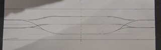

The present thought is something very simple akin to the attached, and quite happy for it to be fictional although it must have a Scottish aspect to it in some way. the sketch which was drawn many moons ago now is what we thought could make an interesting concept, well two concepts considered really.

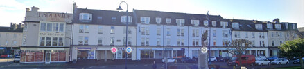

1) the double track swings and follows a road to the front of some properties similar to the photo of Rothsay water front, a few buildings of slightly differing designs but most importantly not overly difficult to model, the single track at the front would go along a sea wall, for deliveries off sea going craft, or just a layover point for vehicles out of service.
2) the double track swings and follows a road to the front of the layout, while the single track could go off to a layover siding cum stabling point with possibly a wee storage shed and possibly a wee good shed along the lines of the one at Ramsey (prototype for everything floating around the grey matter), not sure what the backscene would be for this option though :think: , possibly a stone retaining wall with a something??? backscene.
Which ever scenic option we go for using this track plan, it will be built on two 1.5m long x 600mm deep baseboards, which with some fiddling and firking can could be accommodated in my wee room without going in to the hallway, the only time the two boards would need to be assembled together tough would be when track is laid across the board joint and when any scenic colouring work was carried out, a cost exercise should confirm however if a temporary kitchen occupancy permit could be obtained, it has happened once before and it only cost one evening out for dinner and the cinema.
