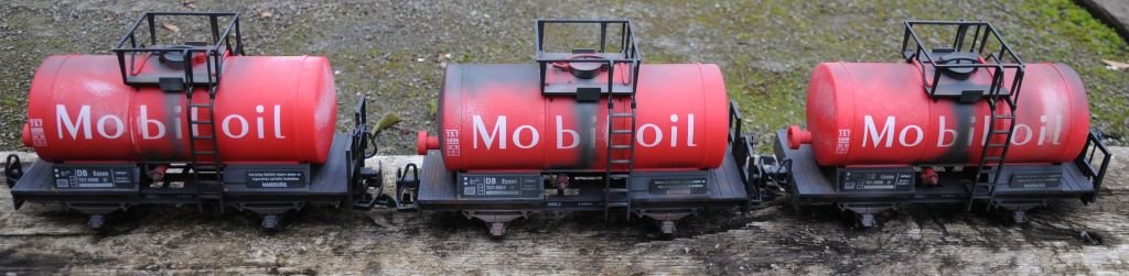

i have some of these, as you pictured above.
if used on small diameter curves there can me problems.
look from below, you will note, that the couplers are not the same length.
functioning workarounds:
either,cut away the platform and shorten that coupler.
or convert it into an eight-wheeler with body mounted couplers.

let me introduce :
the whole business with couplers are relations.
from my point of view,
1) the longer the distance from fixed axle to loop, the more delicate.
2) the greater the difference in length between two couplers, the more derailments.
3) treat fixed coupler-bars on trucks as "body-mounted" (to the "body" of the truck)
remember the old greek guy? the one with the triangles and so on?
he was right. the length of the lever influences its movement.

let me introduce :
