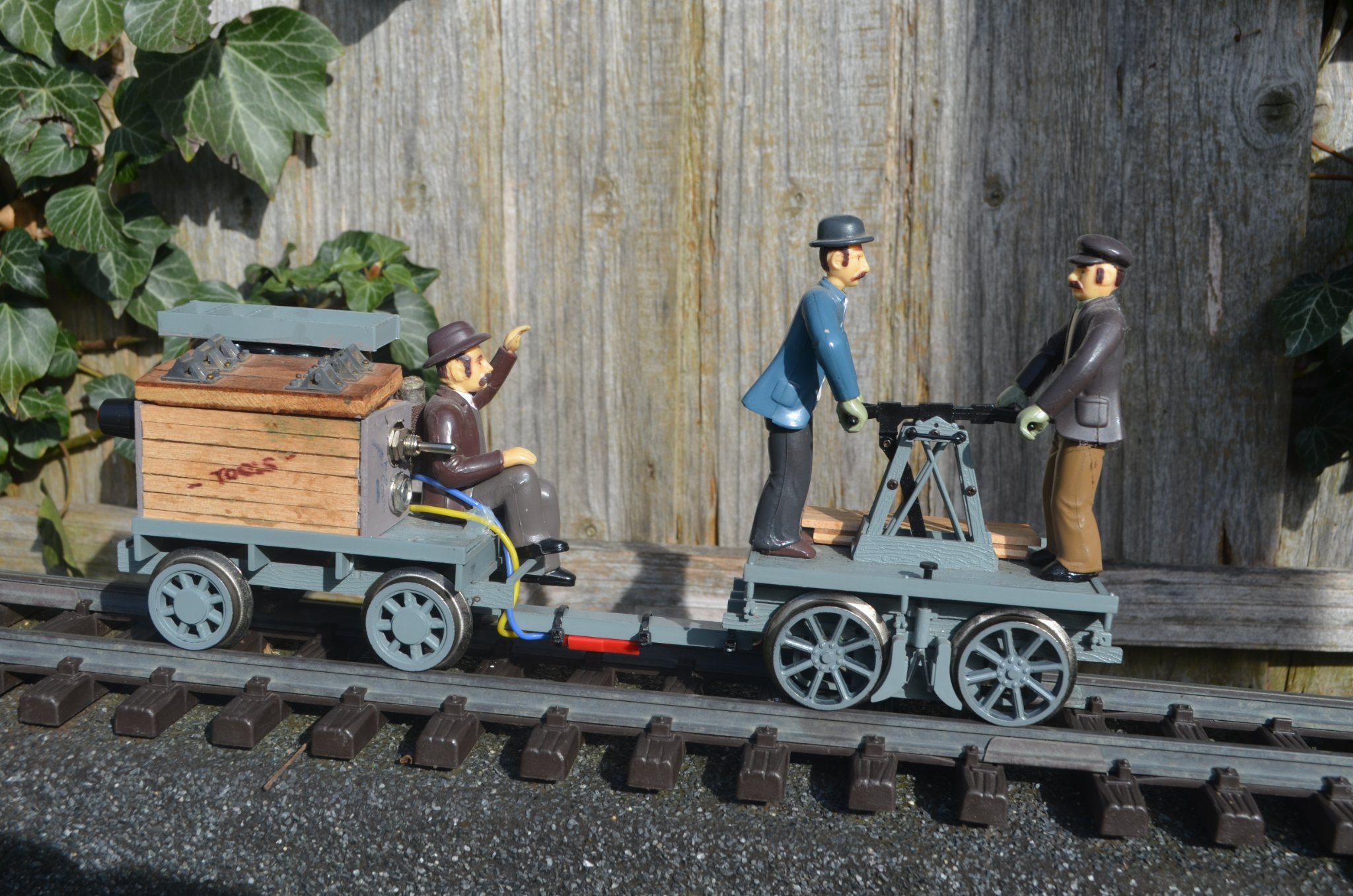

The Boss talks to Dai whilst Abner prepares for more back breaking toil.image.jpeg The CFR "Gandy Dancer" has been very busy today. It operated from 9am to 3pm and covered an actual 8 miles on one charge. Operation was only curtailed due to debris falling from the trees onto the track.

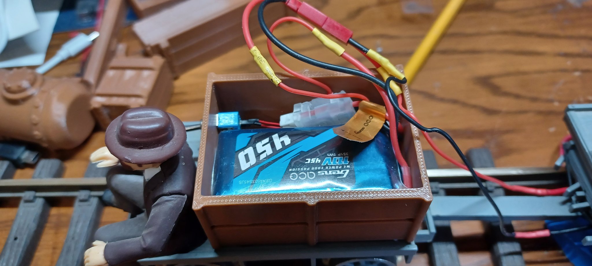

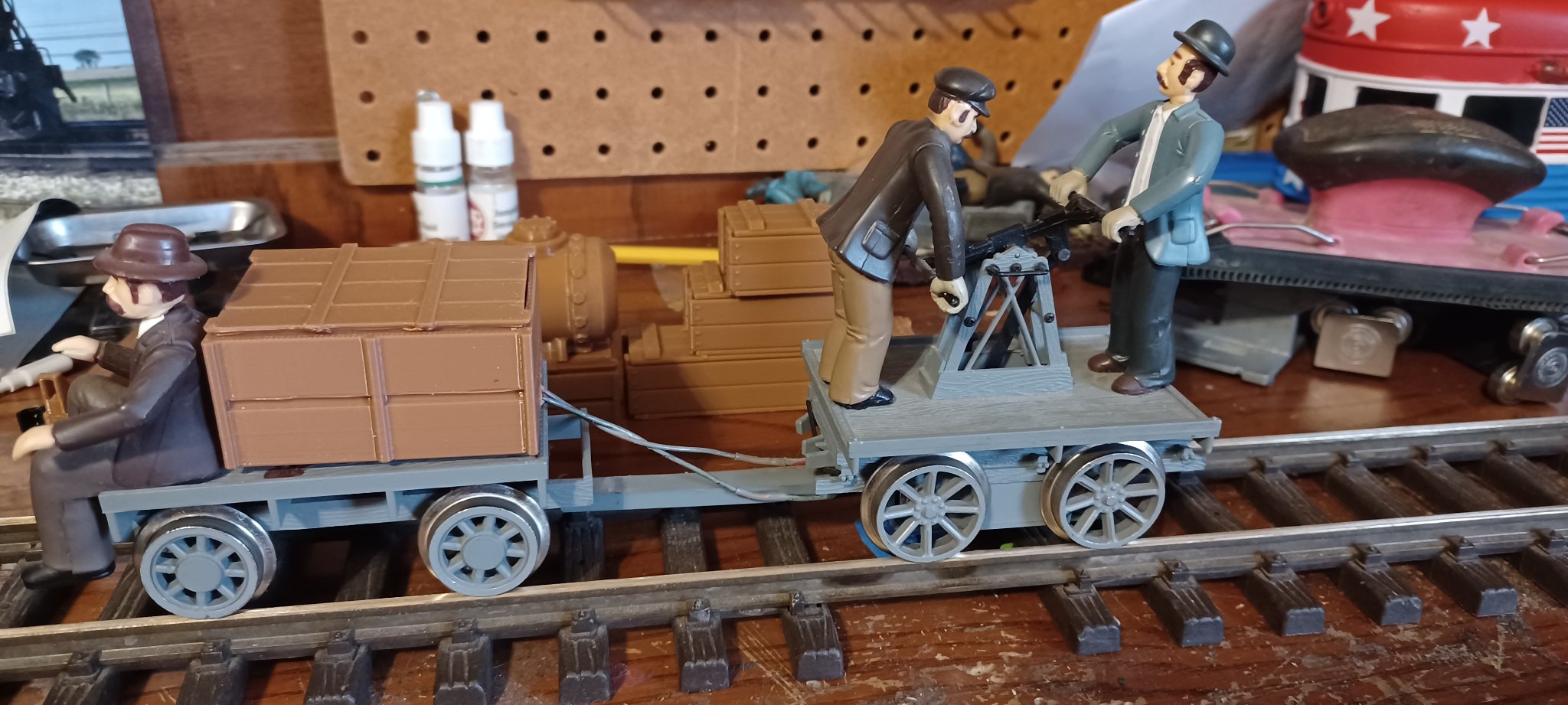

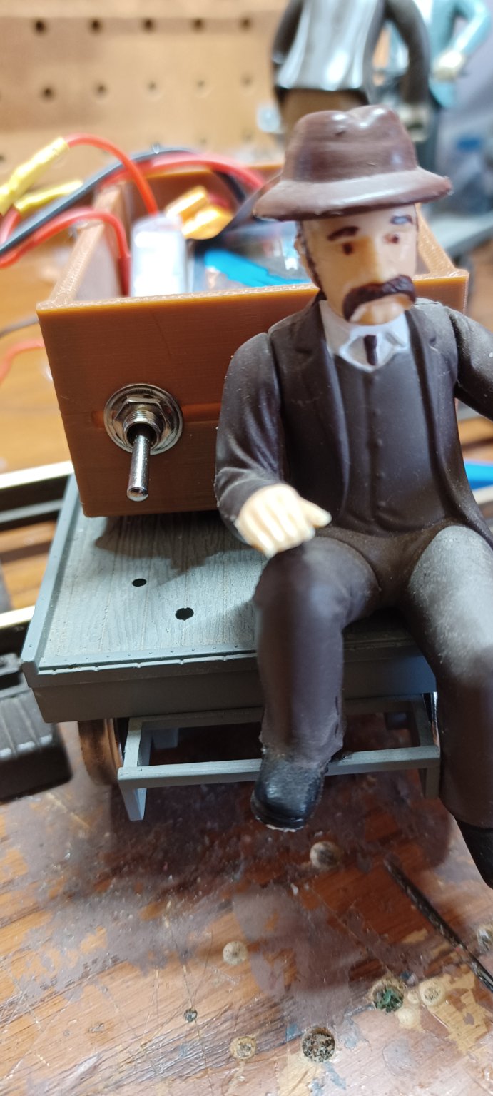

I know this is a very old thread but I thought I would pictures of a bachmann Grandy Dancer I converted to battery power with a lipo 11.1 v battery. I get over 2 hours of run time between charges. Added an micro toggle switch and at 11v it runs at about the right speed. I printed a box to hide the batter in.

I ran the wires through the bottom of the battery box and painted them gray so they don't stand out so much.

I don't have any type of speed control on mine but a 11.1v 450 mah battery runs mine for 2 hours plus. And the speed is just about right for a hand car.
Charging at 1amp takes 30 minutes.
