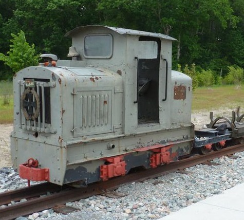

As you can see from the video, my next stage will be to convert the body to something more like a conventional centre-cab diesel loco such as this one.....

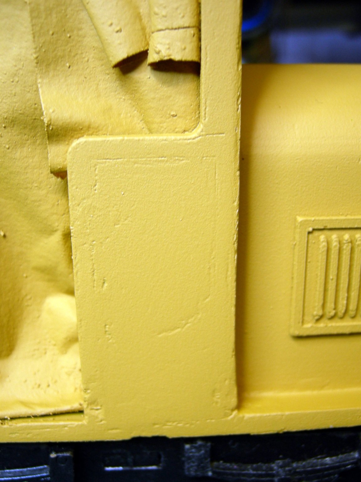

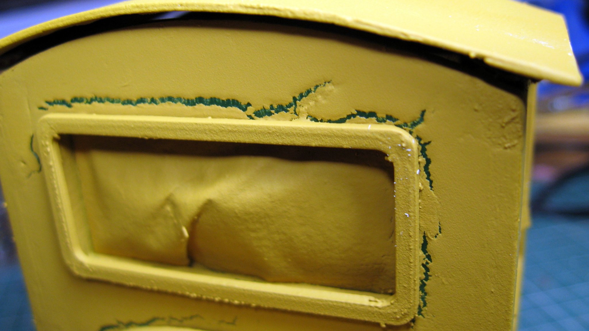

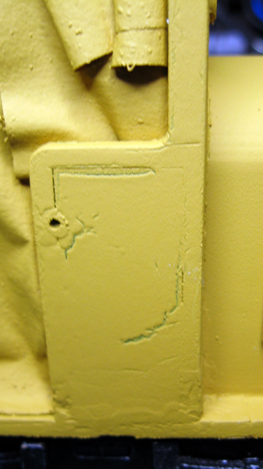

Two steps forward and one step back.
I decided to move the cab back by 15mm to tie in with the loco I'm using as my inspiration. This required quite a bit of hacking about with a razor saw and Stanley knife. The old body was rubbed down and I then glued on the bonnets and window frames and gave the body a couple of coats of Halfords plastic filler primer.
So far, so good. However unfortunately, the primer reacted badly with whatever paint had been used previously ....
This has happened before with other models I've bashed over the years. So, more filling and rubbing down required.
I was determined to keep as much of the original locos as I could (in true TV Repair Shop fashion), but I'm beginning to wonder if it might have been easier to 3D print the new body in its entirety. Such is life......:rolleyes:
Rik

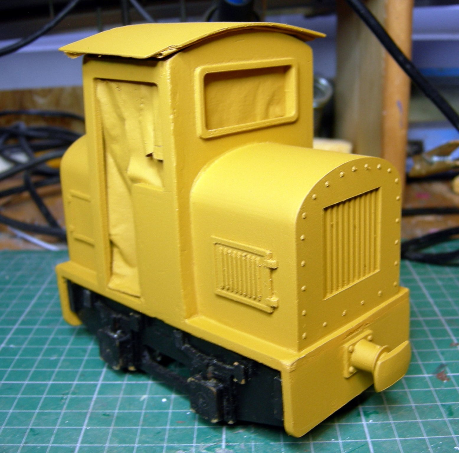

I've now done a bit of remedial work.
Most of the deeper crevasses have been filled and flatted, but there are still a few dints to be filled and a few hillocks to be smoothed off.

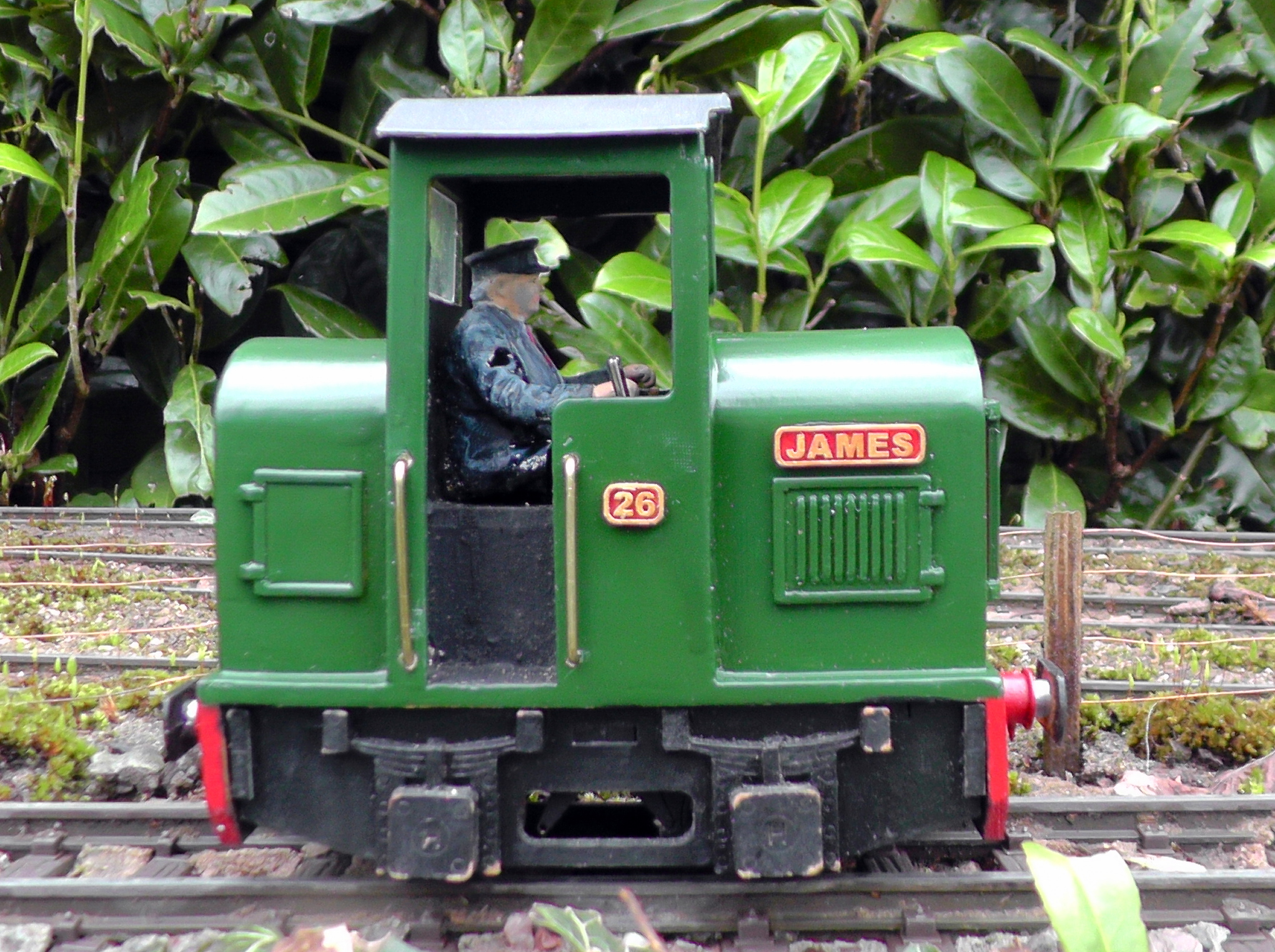

Apart from the addition of couplings plus a bit more detailing and some minor tidying-up, the refurb is more or less complete.
Rik

I was asked on Youtube about the hauling capabilities of the loco. At the time, I had no idea. But I added couplings yesterday and so today did a highly sophisticated load test - basically adding wagons until the wheels just started slipping. It pulled 13 LGB skips plus a brake van. Far more than I will actually need in practice as James performs shunting duties at the sand quarry sidings.
