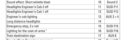

5. Instructions only show functions against f-key numbers not CS3 screen icons, so a lot of trial and error to work out which does what. I need to switch to my Massoth set-up and work through the multiple options.
6. I can't work out how to get the driver's cab light to illuminate going forward; the empty cab light works in reverse; more experimentation needed here

6 - you'll want F13, and its directional. The car with first class is actually the rear and the second class is the front - the one with the motor blocks and pantograph.
7 - All the screws to open it are on the bottom and there are a lot. Its a bit of a bear, the intermediate cars are easier.
