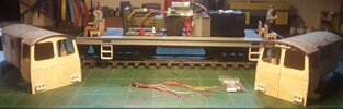

I decided I had had enough of the Funkey and the silly RC used to drive it (no criticism of the builder it was superbly done and ran very well), so out with all the gubbins that made it go. R6M and Planet out/not to be used any more, double circuit board Rx/drive converter?, Alco Sound Unit Micro Controller out, most of the wiring and other sundry bits n bobs even switches out, magnetic controlled uncoupling system out. Such a relief, Fosworks replacements ordered yesterday so it can be made into a really useful engine (for me and my visitors) that I know is in there.
What has stayed in is connections to motor block wiring, speaker, batteries and possibly board with resistances to be used on lighting circuit.
Last attempted use was on a visit to casey jones snr casey jones snr CFR a year or 3 back where it would not work. Likely a loose wire found whilst pulling it to bits! Still I do hate double stick RC systems so it has been on the books to do for some time.
The box at the front of the chassis contained all the gubbins and complex wiring.
Below can be seen all the removed bits. The switch and charge socket will be revised to replicate a Fosworks wiring loom (my standard).image.jpg
More to add when Fosworks bits arrive, there will be a lot of spare room in the body!
