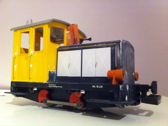

The Kof bonnet now sports a full set of handrails. The top ones are triple mounted, the middle being a cheat with superglue rather than solder, although I may strip them off and solder this connection. I also drilled out the holes to attach the side mounted headlights. Next up more Milliput on the chassis and can before the cab handrails and door handles.

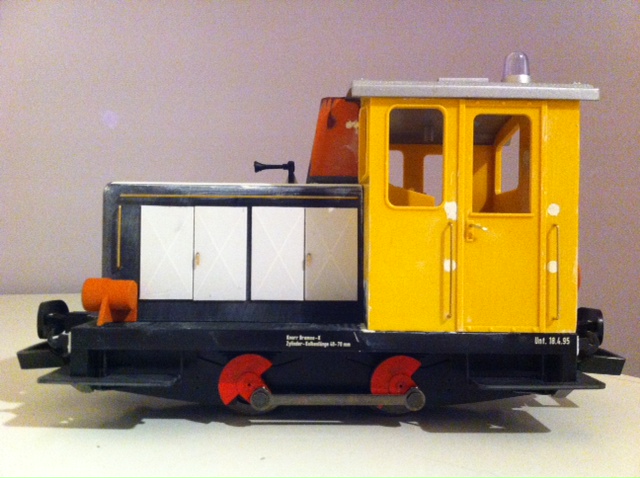

As my model is inspired by the Zillertal O&K I have added shunters foot boards to each corner of my model. These are 60thou plasticard, superglued to the step and the front of the buffer beam. Small strengthening fillets (as prototype) were added from 40 and 60 thou plasticard.
The Zillertalbahn also uses cable shunting to load roll-wagens. It's shunter has an additional hook on each end. I fashioned these from 60 thou plasticard, with a knife and file. They were glued to a rectangular piece of 40 thou plasticard and superglued to the bufferbeams. Bolt head detail is from styrene section.
You might also see the cab handrail holes are drilled and I've made a start on the rear headlights. I've also got bonnet door handles to add, and some hooks to the underframe which I believe are to support a spare coupling bar (for a roll-wagen). More soon...
Re:Kof cough... LGB in to Liliput does go...

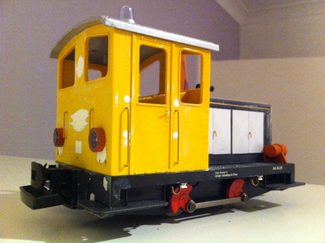

Tonight I've managed to finish off fitting the handrails to the cab and bonnet of the LGB/Liliput KOF diesel shunter bash. I have also fabricated some small brackets on the drivers side of the diesel. On the prototype these are moveable so they can be pulled out to support a roll-wagen coupling bar. I've not made mine operate, but they should look good touched in red when the rest of the model is finished. I'm going to make a dummy coupling bar, but just like on the real engine, this is often stored on the bonnet footplate rather than on the brackets!

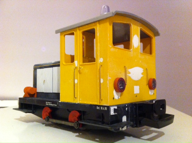

It's been a week or so since I posted last, and in that time I've only made slow progress but I have fitted the rear lights to the cab. These allow the use of the original Liliput LED lighting which keeps things simple. I have removed the raised bevel on the face of these round mouldings, and intend to turn them on my drill to put a curved edge and thin them down a bit.

So just a few more touches then before I can get a coat of primer on it and see how it's looking!

Tonight I've applied the first coat of Halfords plastic primer to the LGB Liliput Kof Davenport bash!
It's hi-lighted a few areas needing more smoothing before I add a second coat but it's great to see it as you always get a good feel for the finished model.

Thanks chaps - I'm really please with how the rear of the cab has turned out, you can't tell it had 3 massive lamps, a waist band and other raised detail at all now :)
