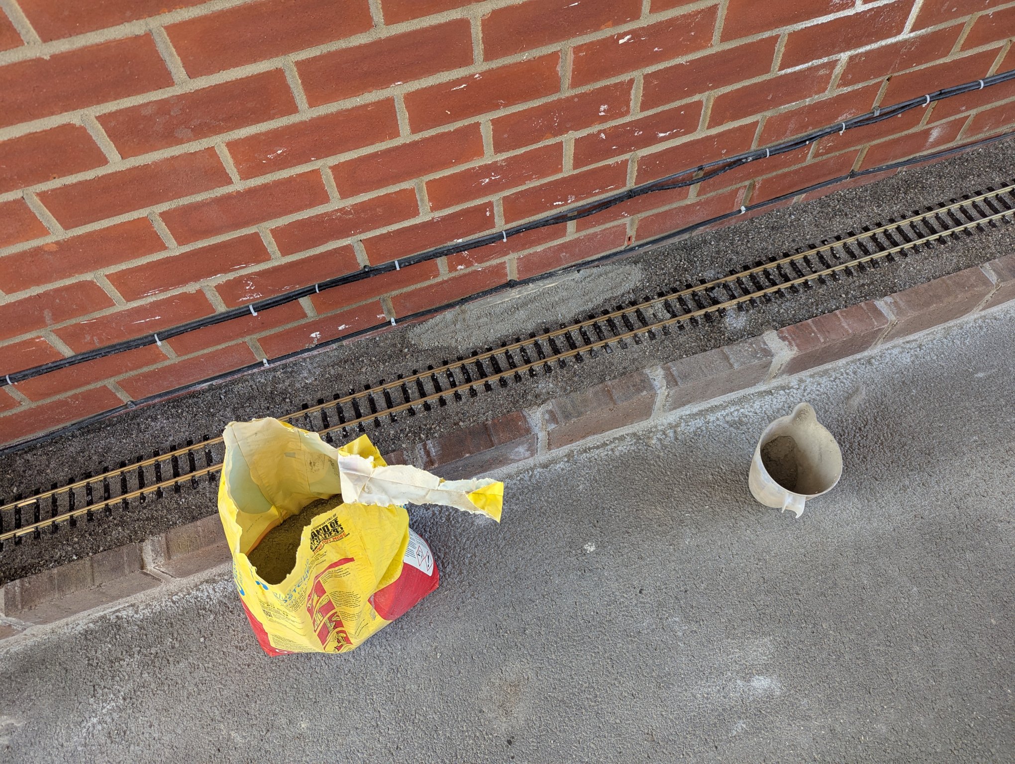

After not being entirely happy with the ballast around the wall breathing vent, I am now very happy. Bit of wood, bit of postcrete, and happy.
View attachment 341029View attachment 341030View attachment 341031View attachment 341032View attachment 341033View attachment 341034
That's a vent to provide cross-ventilation underneath your floor. I assume the floor is concrete beam and block.
The little plastic weepholes in the perp joints on the next course are to allow any moisture in the cavity to drain away, which would indicate that the course where the cables are clipped is DPC.
Notwithstanding, always keep vents at ground level open, so that they can do the job they were designed to do ;);)
The purists would argue that the railway is too high in relation to the DPC, but with the type of construction you have there, I would suggest that there's nothing to worry about - don't let it go above the DPC anywhere.
Ahhh yes, I've made sure that the railway does indeed never go higher than the DPC, and all the vents are indeed clear for air to flow.
agree, dont close or obstruct them.
In this setup even rainwater will go under your floor.
there will be not enough air/wind flow under your floor to prevent fungus or buildup of moister, even if with a concrete floor you should keep them open.

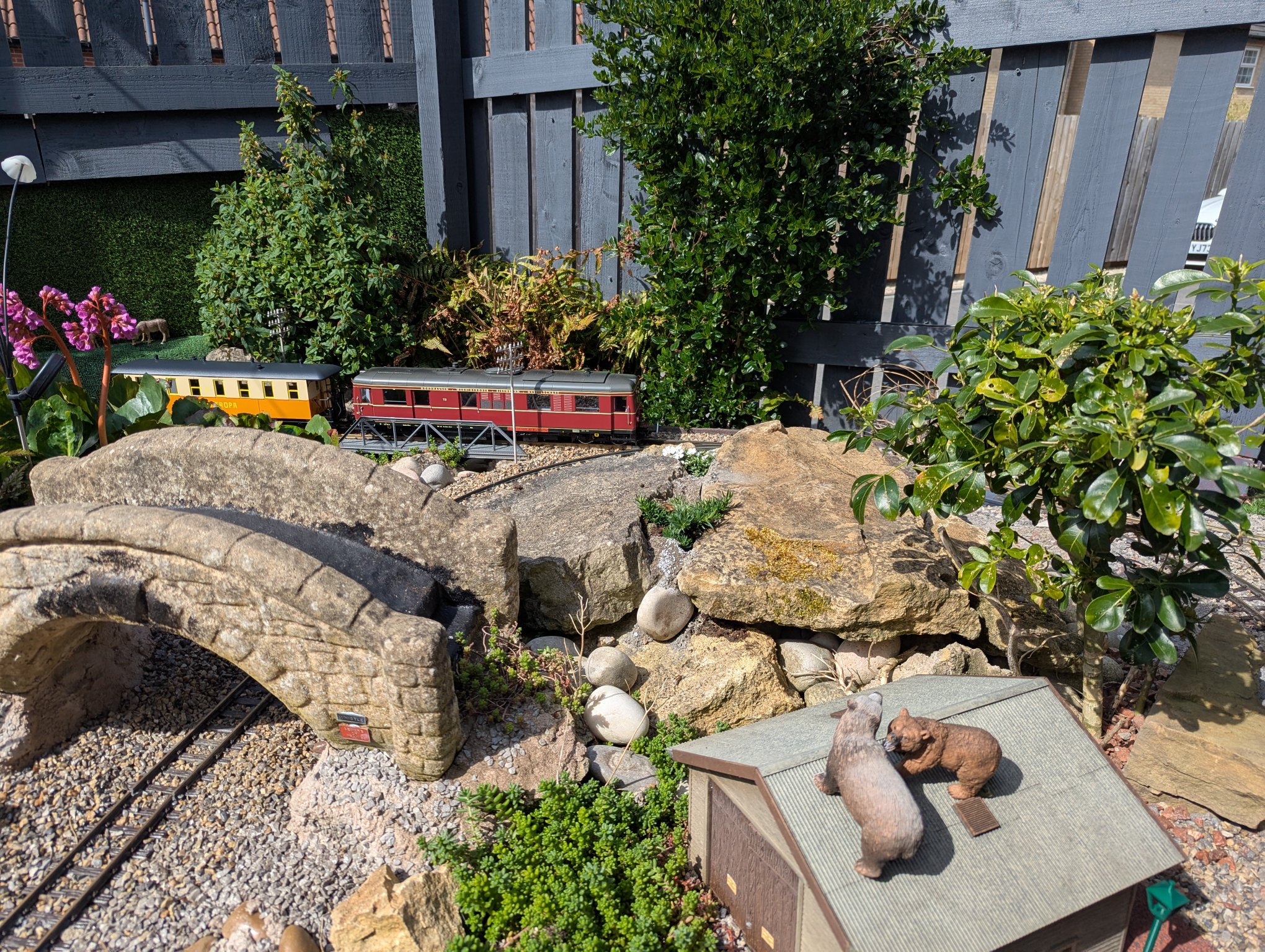

And of course a little train. It's about all I can get out at the moment. The stock cupboard is blocked by bathroom tiles and general decorating stuff....

No worries, they're all open, none have been blocked up.
